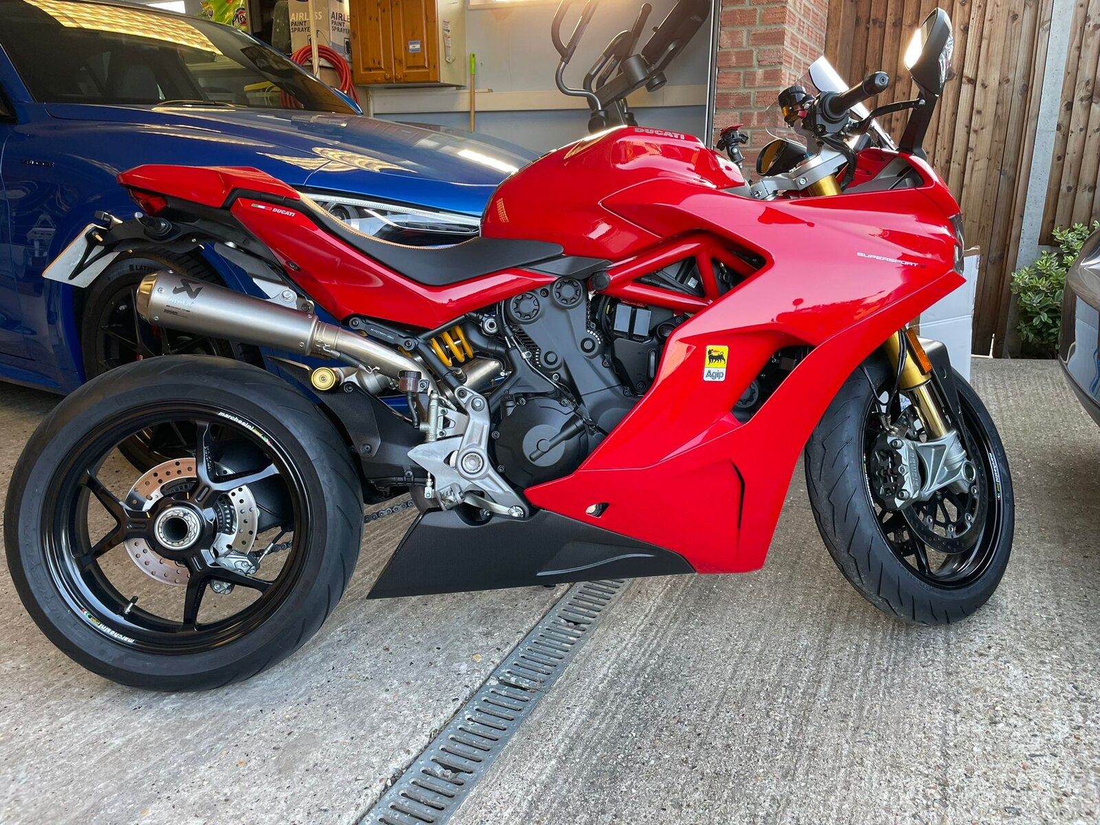

  2. Just a follow up, Fullsix Belly Pan bought and fitted :cool: WhatsApp Image 2021-09-05 at 17.57.52.jpeg
  3. So was it easy?
  4. Yes apart from the left side. Doesn't come with any installation instructions or fixing screws.
    Couple of the fixing points to me look for like they're for the stock exhaust system. Anyway cut a long store short, bought some stainless steel screws from Amazon to fix to these points. I'm the 3rd owner of this bike and don't have the original parts that where removed. So I had to buy a couple of fixing screws.
    The left side brackets has to fit UNDER one of the left fairing brackets, took me a while to work it out as the left side would not line up at all. Some instructions would have saved me some time and messing around.
    Anyway end result is I feel it finishes the bike off. I'd love a Panigali, but arthritis in my lumber spine makes a full blown sports bike to painful to ride, for me the Supersport S is great, sports looking bike with an upright ride.
