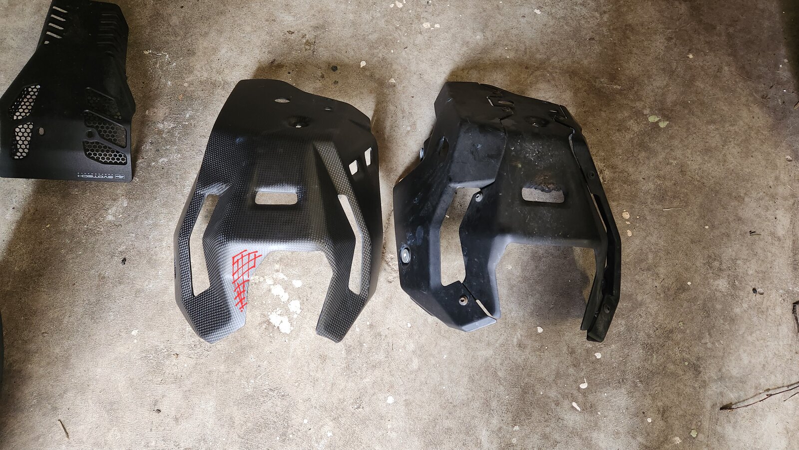

  1. So I treated my self to more carbon tinsel and I got delivery of the Fullsix carbon belly pan: https://conquestracingltd.com/produ...istrada-950-1200-1260-carbon-fibre-belly-pan/
    Problem is, the front exhaust header pipe sits more in the middle which the above belly pan is off centre, I've heard of people having no issues fitting this so I'm curious, has anyone bought the above (doesn't have to be from conquestracing, just the Fullsix bp) and managed to fit it with the OEM header pipes? As from my understanding, the full termi system doesn't change the header pipes.

  5. Got it, I'm gonna tackle it again this weekend as I need to do some more work on the bike, I'll grab pics
  6. Dremel is you friend.
  7. Had a look again, it's got to be a mold error, I'm gonna make some adjustments
  8. You shouldn’t have to do that. I bet it wasn’t cheap, so can you not get onto them to send a part that actually fits?

  11. All good and VERY sound advice indeed, got my overalls, mask and goggles and hair net (yea, I too have seen first hand what bad PPE can do with cutting cf).
    Actually, I've got 5 mins free, let me go grab a pic.
  12. In the pic you can see the mold error. The reason it doesn't fit is that extra overlap pushes on the header pipe and won't let it fall into place. So it needs cutting. I'll cut out, sand down and put a new epoxy coat on the raw surface and maybe a satin clear coat over the work area if needed
