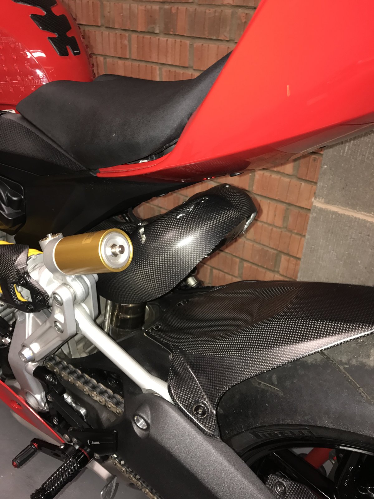

  3. C8A33A8A-4EC5-49E9-8949-2EDFA1822995.jpeg Here’s a picture of mine from when first fitted
  4. Appreciate that thanks very much. So obviously you fitted it yourself... how much of a faff was it? Also what brand of rear hugger is that? seem to match well

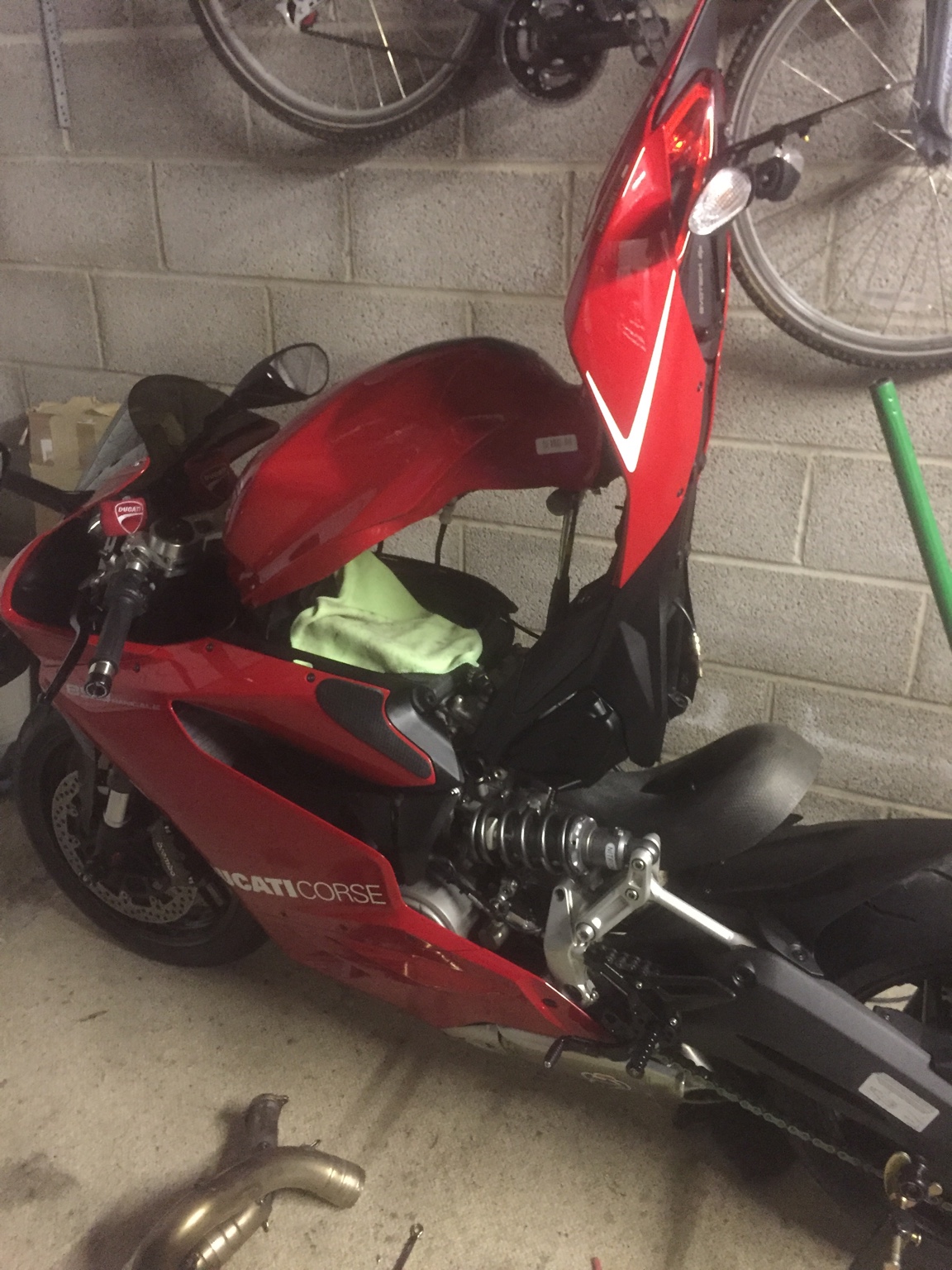

  5. Yeah I guess it is a bit of a faff, but being a mechanic/engineer by trade not a massive mountain to overcome. Basically all you have to do is lift the tank, undo the lower rear subframe mounting bolts, loosen the top mounting bolts and then lift the rear subframe to access the bolts on the top as there is not enough clearance to remove. I beleive there is a thread on this somewhere on the forum but here is a picture from that thread to show you.
    The fullsix carbon heatshield is definitely more a a matt finish than the dp matt carbon. In the picture i previously attatched I had wiped it over with some silicone spray on a rag to clean...
    The rear hugger and other carbon on my bike is all DP. Hope this helps.
