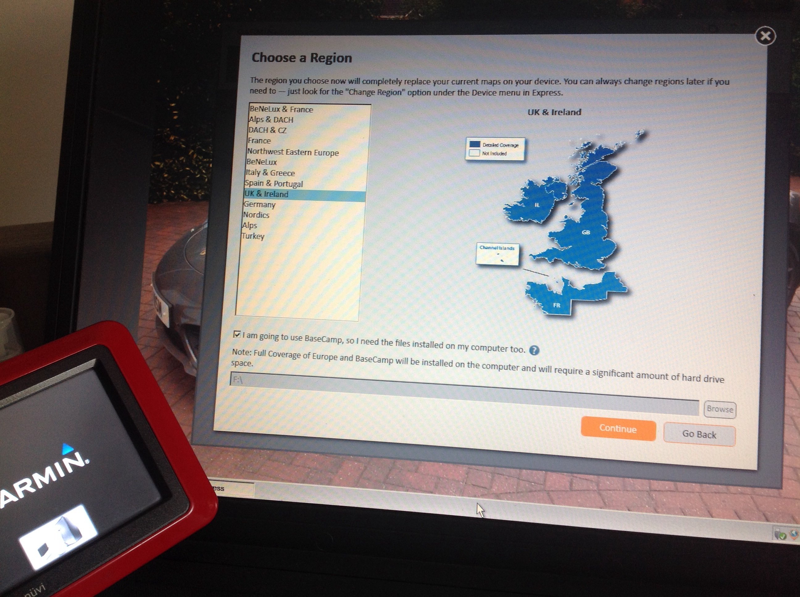

    Try a master reset, although before you do that, download Garmin Express (www.garmin.com\express) and do a backup - this should save all your previously found places/routes etc? For the reset, press and hold the bottom right hand corner of the screen at the same time press and hold the power button, until it asks you if you want to go ahead etc......then it needs to be left under the open sky for 30 minutes.

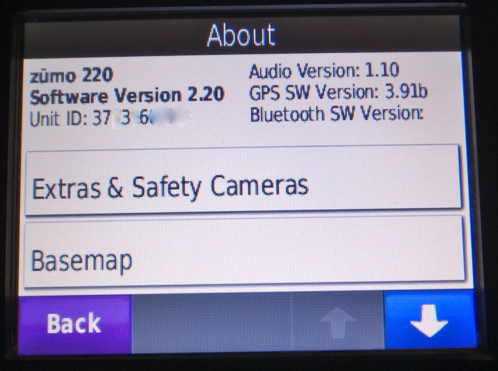

  3. For whats it worth, currently operating two older Garmin Zumo 220 (1x Ducati Red AUS+NZ base map / 1x Garmin Grey AUS+NZ base map) with motor vehicles. The two Garmin Zumo 220 work spot on (no map offset issues) reliable and very fast over here in China with Garmin mini SD cards.
    Both Garmin Zumo220 running old Garmin software 2.20 version (blanked out Unit ID numbers in pic).
  4. You may need to update your maps, latest euro map is 2014.4 and you need about 4GB of space for the whole of europe. The Ducati branded sat nav has a 4GB micro SD card installed, the units internal memory won't hold the whole european maps you can select the maps for your route using garmin mapinstall.
