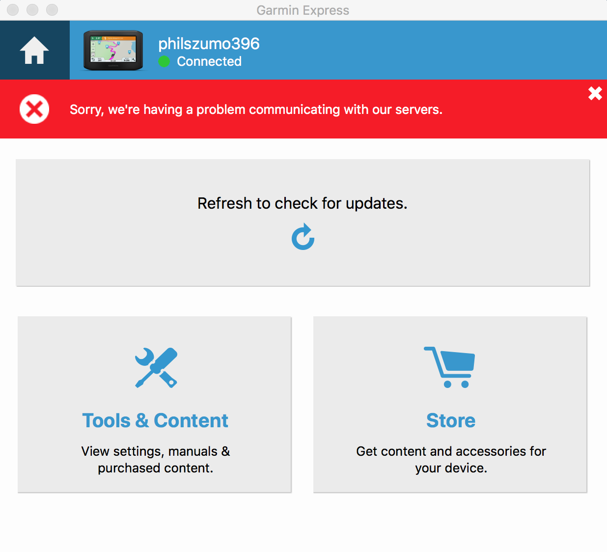

Anybody else bought one? So far (three days in updating and testing in the car) and I have to say I think it’s pretty poor. How come my phone can calculate a route in seconds but it takes this at least two minutes to do the same? The screen then freezes so no visual guide to roads and turn offs whilst the vocal guide continues and when it does ‘work’ it’s totally useless at updating anything above 30mph so can’t see how it would ever update in time to keep up with the multi.

Well well. Couldn’t find how to re-install firmware anywhere. Did find that holding the power button for 12secs resets the unit, so did that. Thought I’d run it up without hooking in to my phone in case there was some kind of miscommunication there and lo and behold it works great! Then I discovered that it was already linked and active with my phone too. Faith restored.... ...until I try Basecamp by the sound of things
