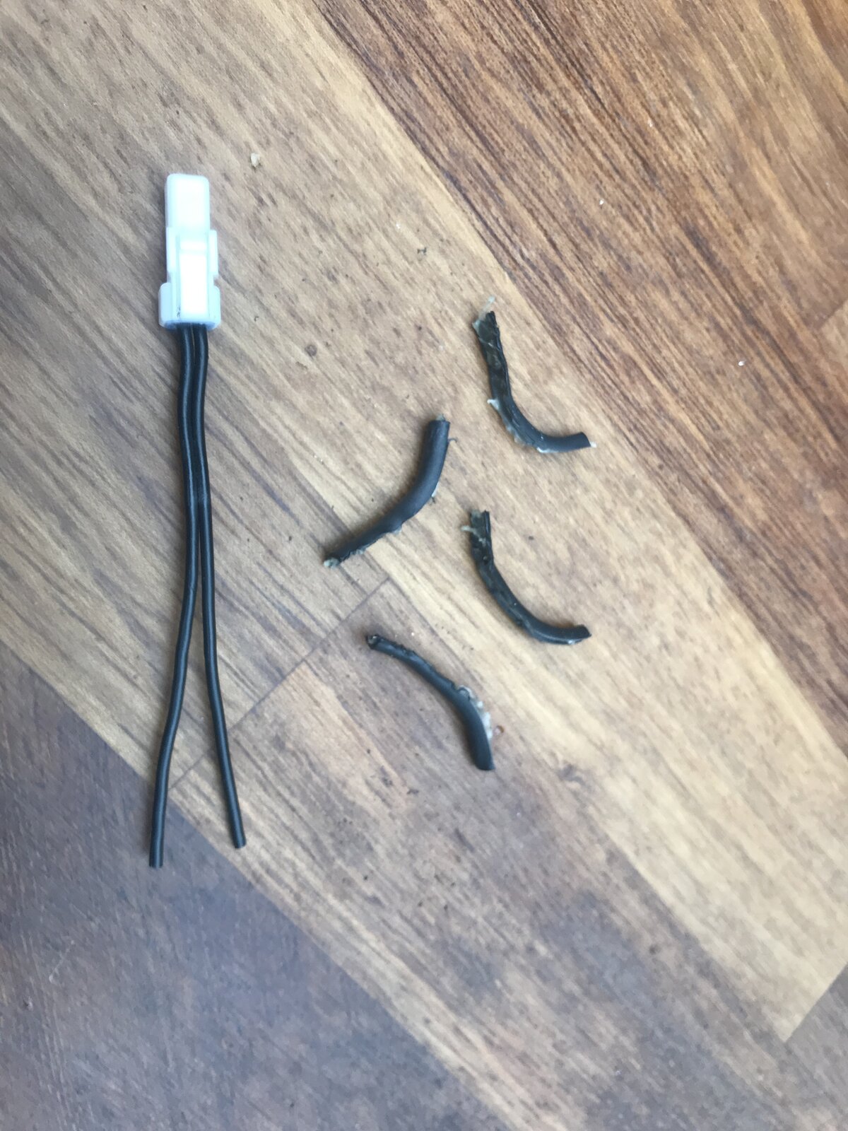

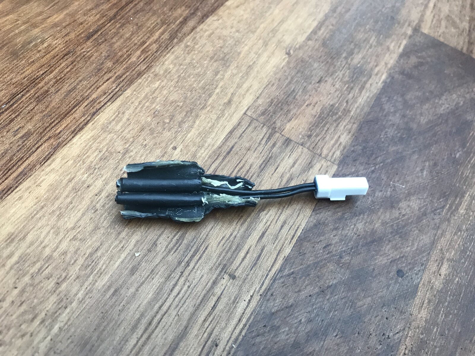

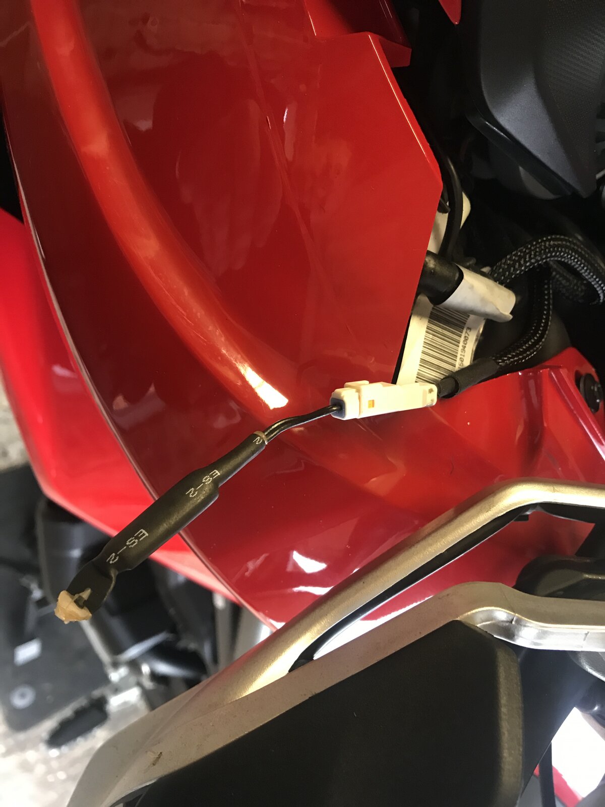

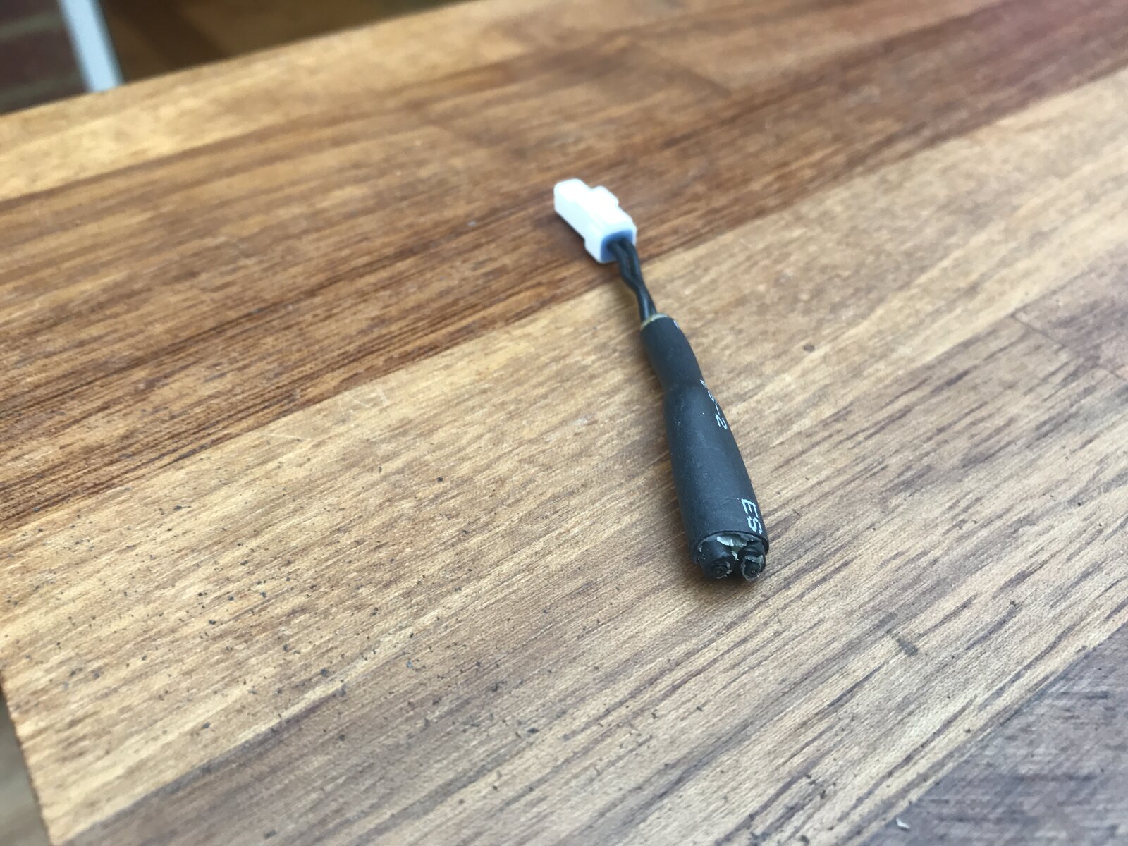

  16. The pigtail is a bit of a pig, sorry, to strip back. I used a sharp craft knife to carefully cut back all the protective plastic casing. Here are a few pics. Sorry about the naff quality:
  17. You just need to find the short pig tail connector that comes with the joke, might be plugged in under the left fairing panel. Put this in hot water then pull off the plastic/rubber bit covering the wires, a quick go with your new soldering iron and away you go. The excess wire ticks under the fairing with no problem
  18. We posted at the same time, as I mentioned just put it in hot water for a few minutes and you can pull it off fairly easily (not a euphemism)
