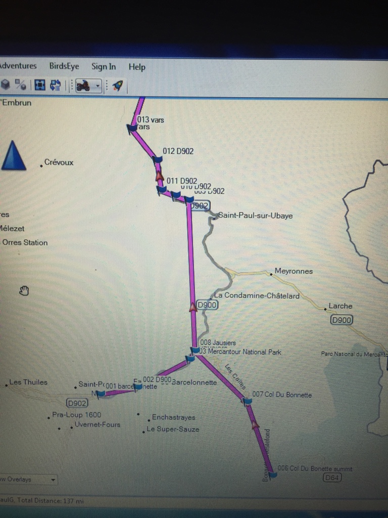

  5. managed to get a work around. ( I hope!!)
    Start a route from start to finish point. ( previously I was plotting the points I wanted to go then to the end) Then start dragging the in between line to points you want to see whilst holding ALT key. Seems to work well and transfers ok. Takes a lot longer as the zoom in out and map detail is crap compared to tyre.
