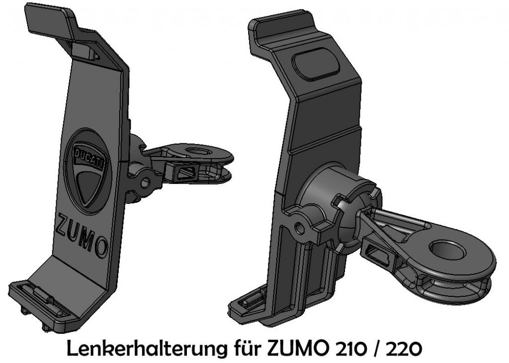

    A lot of Multistrada Drivers have the problem : Were could i fix the Navi ?
    Here are two solutions for the Garmin 210 /220:
    1st soultion. left side of the handle bar :

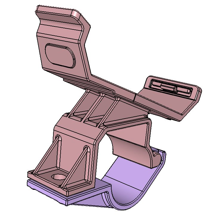

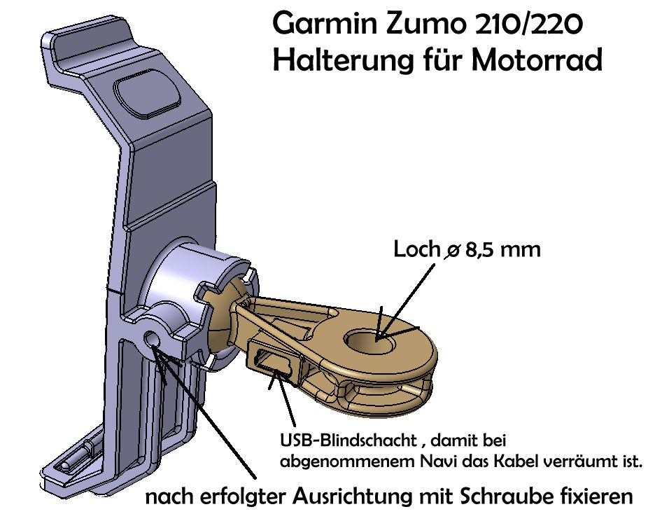

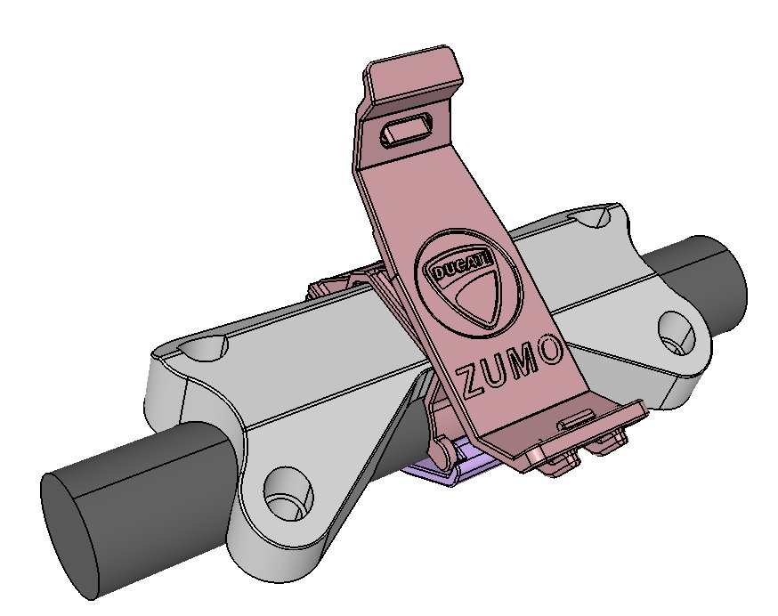

    2nd solution, in the middle of the handle bar :
    ZUMO 210 Halter Multistrada Lenkerbruecke by Varadero on Shapeways
    Solutions with the same Concepts for the Zumo 340 / 350 / 390 are still under Construction.

  2. I will be interested in the Zumo 350-390 option when that is available.
  3. BikePenR is a manufacturer and supplier of mounting brackets for GPS / satnav systems on motorcycles, got a mount from them last year, brilliant = BikePenR
  4. you might want to use the locking mount bracket through, the clip-on mount is only suitable for in car usage imho
  5. I use the clip on mount since 1 Year and i have no problem since 11.000 KM,
    even under bad conditions of the street. I screwed it on the left side of the handlebar.
    It needs very little space and does not look as ugly as the big brackets.
  6. I have the Navihalter mount on my 1200S Sport. It works great and puts the satnav in a very easy line of site.
    however, I like the way that the centre mount works on this one Vau, would it fit a BMW G650 XCountry ?
    When will the Zumo 350 LM option be available?

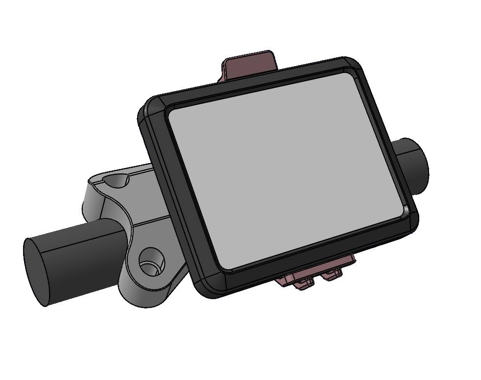

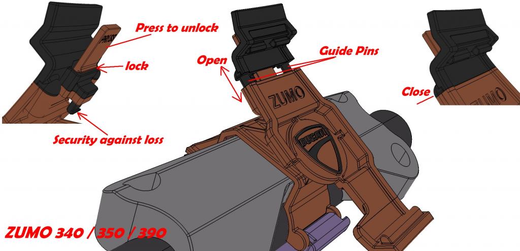

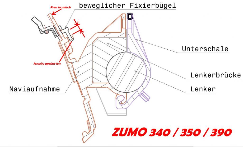

  7. @DaveF:
    it´s still under construction ( look to the pictures after the text )
    The 3D- data is ready to be 90 percent, but I'm still waiting for a Zumo 390 to make different measurements. (I only have a Zumo 210 at home)
    Then I need to create a prototype to check the function. The bracket shown at the pictures only fits on the center of the handlebar of the Multistrada. But I will create also a universal version for mounting on the handlebar right or left . This is then also available without Ducati logo. I think I still need to March.
