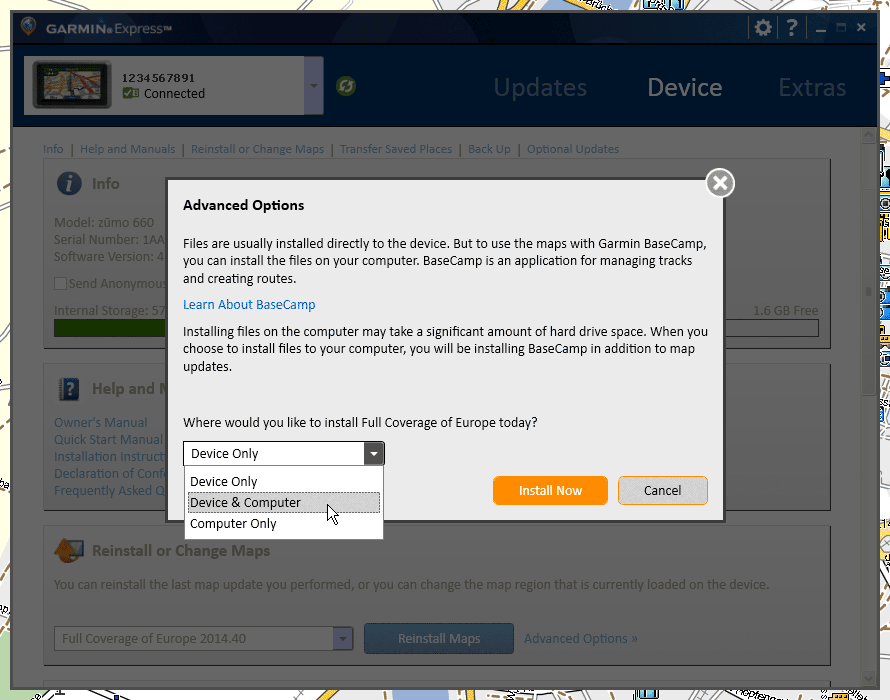

    When downloading mapping data the default is to save this to the GPS only, there is an option in Garmin Express (the update software) to also save mapping to your PC. By doing this the same mapping data that you'll be using on the road is available in Basecamp for route plotting without having to plug in your GPS, it's much quicker too.
    The above are from an earlier version of GE but the current one is similar.
