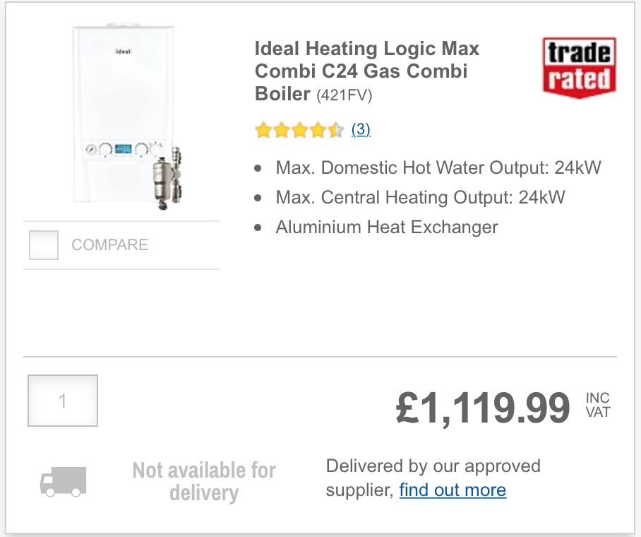

  16. This is prob the direct replacement (But I'd choose 35kW, bloke thing...more powa) upload_2022-12-29_10-52-47.png . This gives you an idea of the cost.
