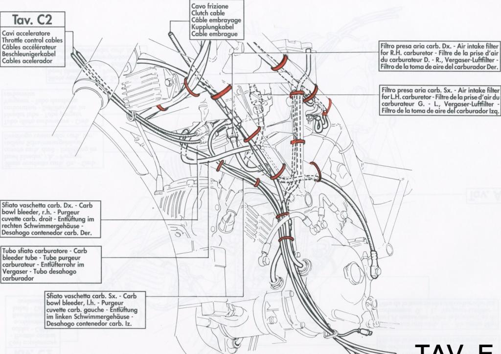

    meanwhile, I've forgotten what , if any hose, goes into the inner carb vent tank - can't for the life of me figure out what the holes in are for or how it works.
  5. Study this, maybe it will help.
  6. Grateful. The air intake filters/tubes - do they just push into the holes in the inner plastic vent box, then?
  7. If you mean the triangular black box, yes.
