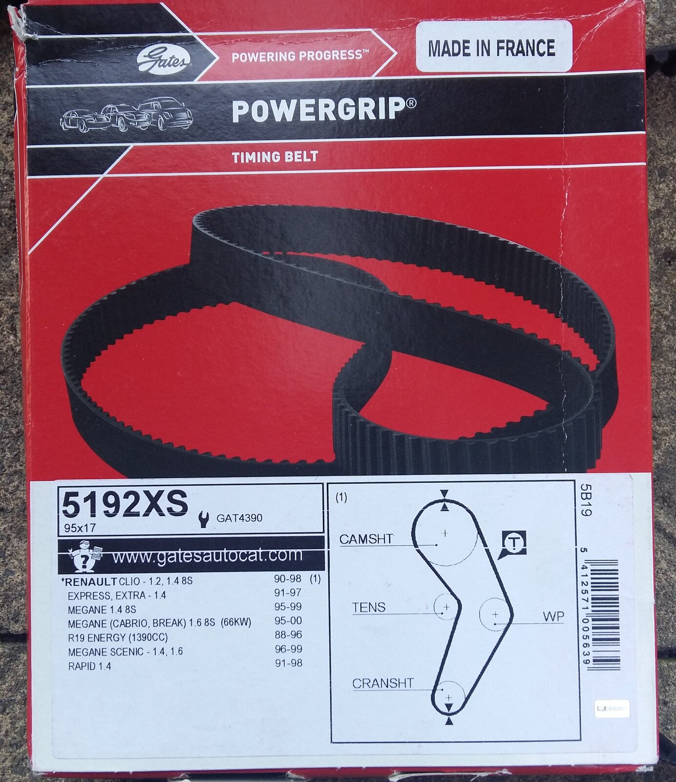

  7. OE Ducati belts are made by Gates. As a punter, Gates will not sell you a “Ducati” belt. What you see in your link is probably the same spec belt for another automotive application like a Renault car. People have been chasing alternatives to the expensive OE belts for years and this is one that often crops up. Quite a few people on this forum change their own belts and yes, you do need special tools. My free time is worth more to me than what my dealer charges and I have more confidence in their work than mine. Andy

  10. same as a renault 5, the dimensions are printed on the belt and half the price for the same gates belt
  11. Is that listed in the Gates catalogue for a Ducati, or does it have the same part number as the one that Ducati supply?
  12. It's listed for a Renault Clio. Part#: 5192XS
    Dirt cheap, and I used them in my 916 without issue for a couple of years. Switched to CA Cycleworks belts because there is more evidence those belts are stronger, plus Chris Kelly is a top bloke.
    The only specialty tools I need when changing are an engine turning tool, the Carbon Drive app for measuring tension, offset 24/22mm spanner, and a 12mm swivel head spanner for tightening the fuji nuts on the tensioner.
