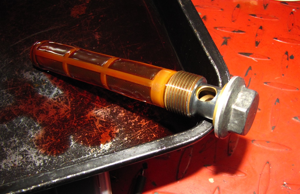

  3. I tend to run 5W 40, engines a bit modified. As regards the filter this is what it should have there... 20200607_083109.jpg

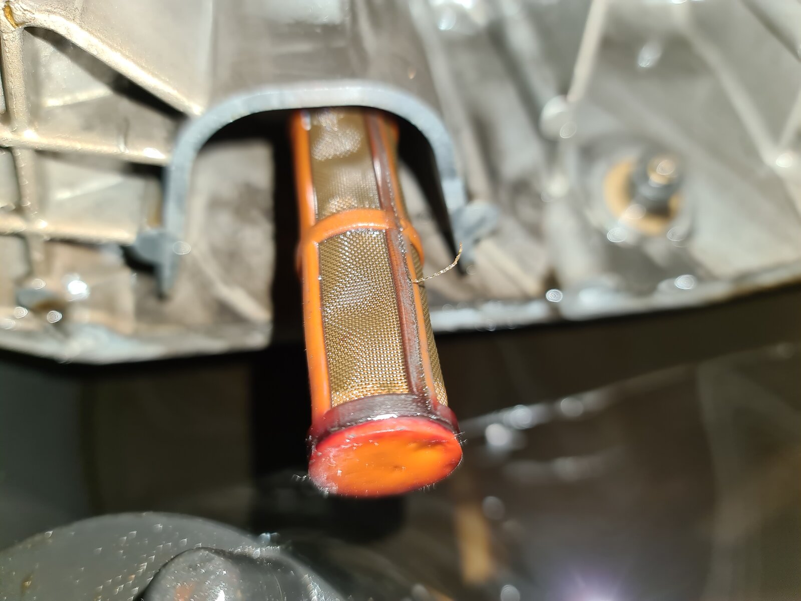

  8. Ok thanks I will have a closer look to see if I can see it, the plug on mine is brass though not steel?
  9. Can see it but can’t get it out, any ideas? I have tried to grab it with tweezers but it doesn’t appear to fit through the hole
  10. The plastic has grown with age, if you can wedge something into the gauze and unscrew it past the threads, it will come out with a bit of persuasion, bit fiddly.
  11. Picture at the top of the thread appears to show the filter exiting the hole backwards? Is it possible to turn it around to make extraction easier / possible
  12. If your 900ss is a 90's model, the filter is the same as my Monster. The top picture does indeed show the filter in backwards. It needs the open end going into the plug which has two holes that allow the oil to flow to the oli pump. Putting the gauze filter in backwards will block the oil flow. IMG_0367.JPG

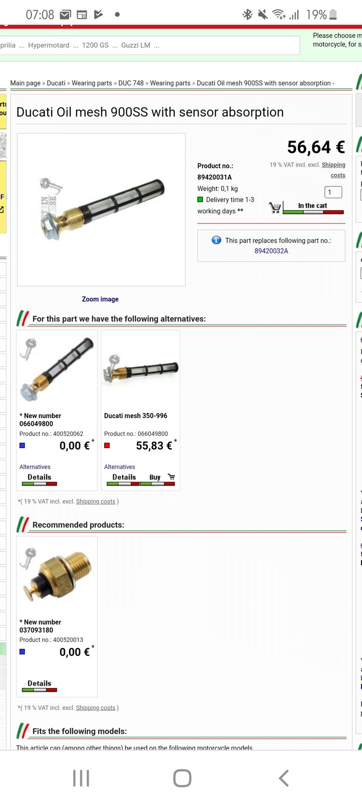

  13. Think I may destroy it getting it out, anyone know the part number of a replacement?
  14. Is that a picture from inside the casing, or is it the filter exiting backwards through the case?
  15. Inside split cases
  16. Yeah, pics from spkit cases as I am currently in my engine. Part number below.... Screenshot_20200608-070834_Chrome.jpg
