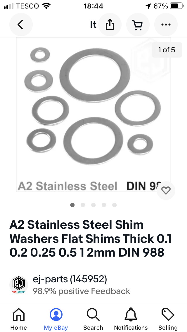

  4. 0403ED0E-8A79-42A3-AEC6-D25B70BB5214.png I went onto eBay a while back and bought some stainless steel shim washers, correct bore and outer diameter, that fit behind and inside(onto) the gear-lever centre bolt. Took 90/95% of all the play out.

  6. You can remove the tightness you’re experiencing by putting a spacer washer on the inside part of the lever, between lever and frame, so to speak.
    If I get time later, I’ll remove mine, take pics and show you what I’ve done. In doing so, you keep the lever waggle(side to side) to a minimum, making the shift more positive in feel.
    I’ll pm pics.
