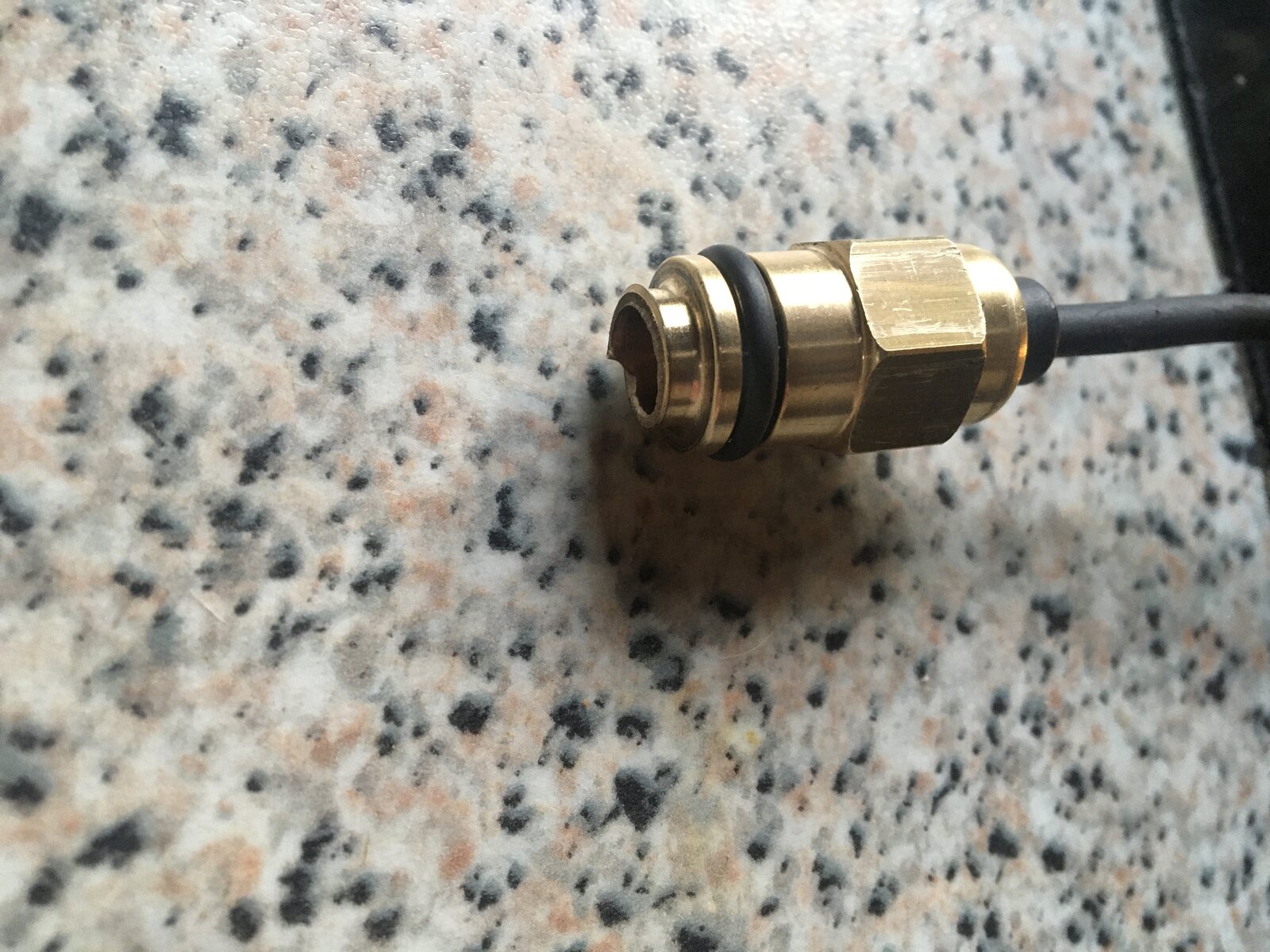

  3. Went to replace the gear sensor today, and the unthinkable happened whilst removing the faulty one… 287D553D-8500-4863-A6BB-E1F3FC15DD76.jpeg
    what would be involved in retrieving that, I wonder?
