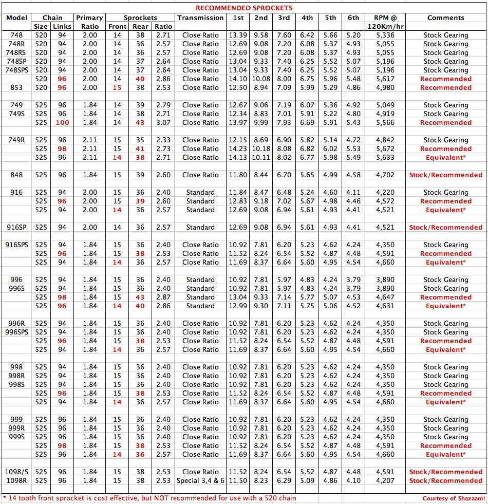

  5. I have a 998 and went one up on the rear sprocket to 37 and that for me was good enough to lower the gearing to a more manageable level. I do use a quick change carrier though and have a number of 525 sprockets, but I have not found the need to change what I have settled on.
    Below might help.
  6. Cheers mate. I may do as the chart recommends and go for a 38T Rear then. Any ideas of good brands I should look at for parts?

    15 Front and 38T Rear is a recommended setup on the Gearing Options - Ducati Up North chart and sounds not too much of a leap but should bring noticeable benefits over the standard gearing setup.
    Having rung a few places, it looks like going to the 14T front is the cheapest quickest mod to feel out the change and then perhaps when things wear more, looking at a QR rear is the way to go.
