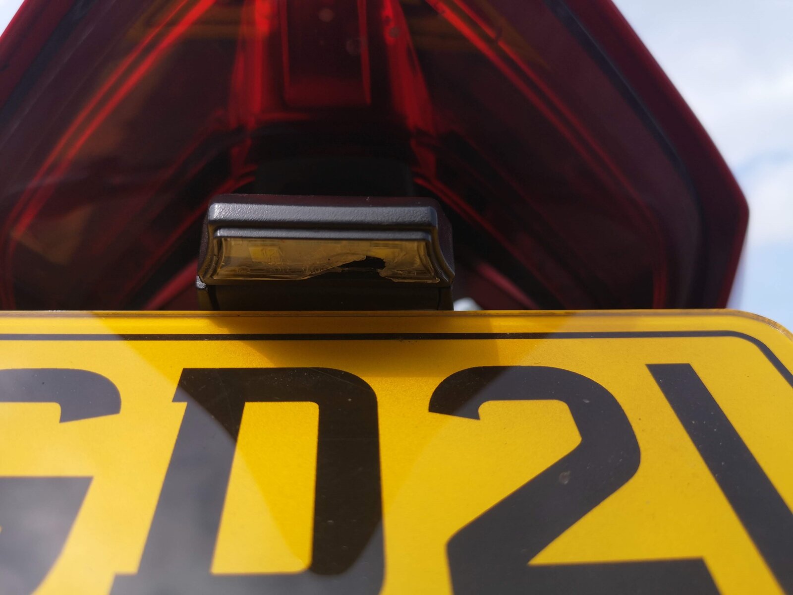

  6. Don't know if you ever sorted your problem.... but mine ended up being the Evotech rear numberplate LED light not working!!!!
  7. That’s exactly what mine was. The number plate lights stopped working. Swapped it out with a new one and the problem has gone.
  8. yep spot on. Had EXACTLY the same error yesteray, yellow triangle popped up, so fearing the worst I headed carefully back to P&H who were kind enough to immediately pop it on the diagnostic tool and it turned out to the be the little EVOTEC LED number plate Light, obviously I've taken a stone at some point and it's chipped and flickers. Some sort of power draw or short then sets the warning off.
    Crazy co-incidence !!?
  9. My Evotech number plate light failed as well. They sent me a replacement FOC but it was a pain to change because you have to dismantle the complete tail tidy.
  10. Just a point of interest. If you can get hold of an offcut of PPF film, then cut some to size and place it over the NP Light lens. Sort of acts like a laminated screen, in that it should prevent the lens from cracking if hit by a rock or debris and even if it does break, it should stop short any such debris from reaching the LED strip inside. You will naturally have to replace the lens if that's the case but it will at least prevent any CAN bus errors from flagging up.
