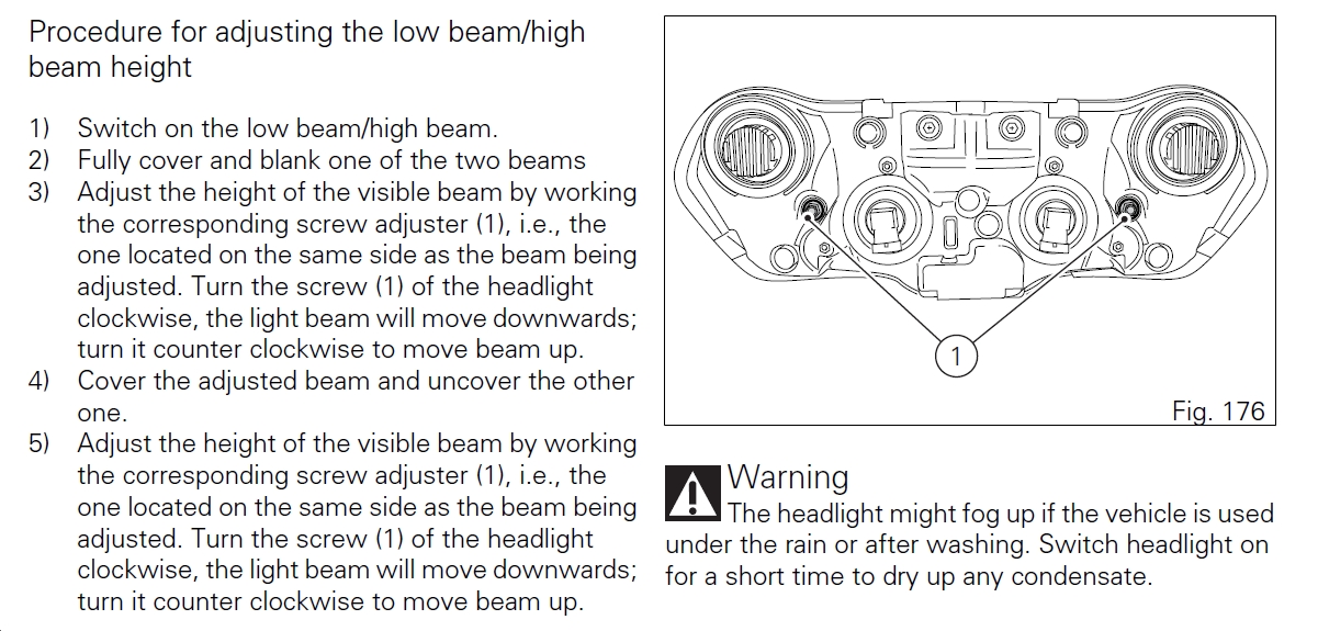

  1. Hi. I picked up a touring S yesterday and last night I was being flashed by a number of people as the LEDs were so bright.
    Has anyone else had this and is there an adjustment that can be carried out?
    Thank you.

  3. Both the main and dip can be adjusted for vertical adjustment. No lateral adjustment as its a flat neutral beam.
