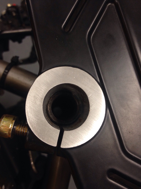

  1. It's about 1mm out and won't go on. What do you do to get it to line up? Pushing the wheel does not seem to help.
  2. Take the wheel out and slacken the lower yoke clamp bolts.....
  3. Haha fail! I was pushing the wheel the wrong way....
