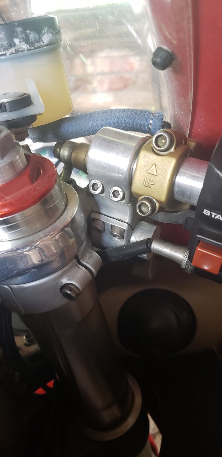

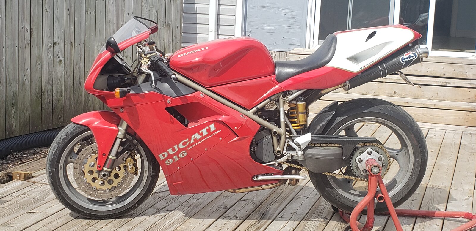

  8. Yes, anything above 1" will require different (lower) brackets for clutch and brake reservoirs.
    Worth it, imo. I posted these pics of my 916 a couple of weeks ago showing 2" risers which greatly improves riding comfort:
    16551423257095027330348576250252.jpg 16551422344857673062285437563396.jpg 20220406_131310.jpg
