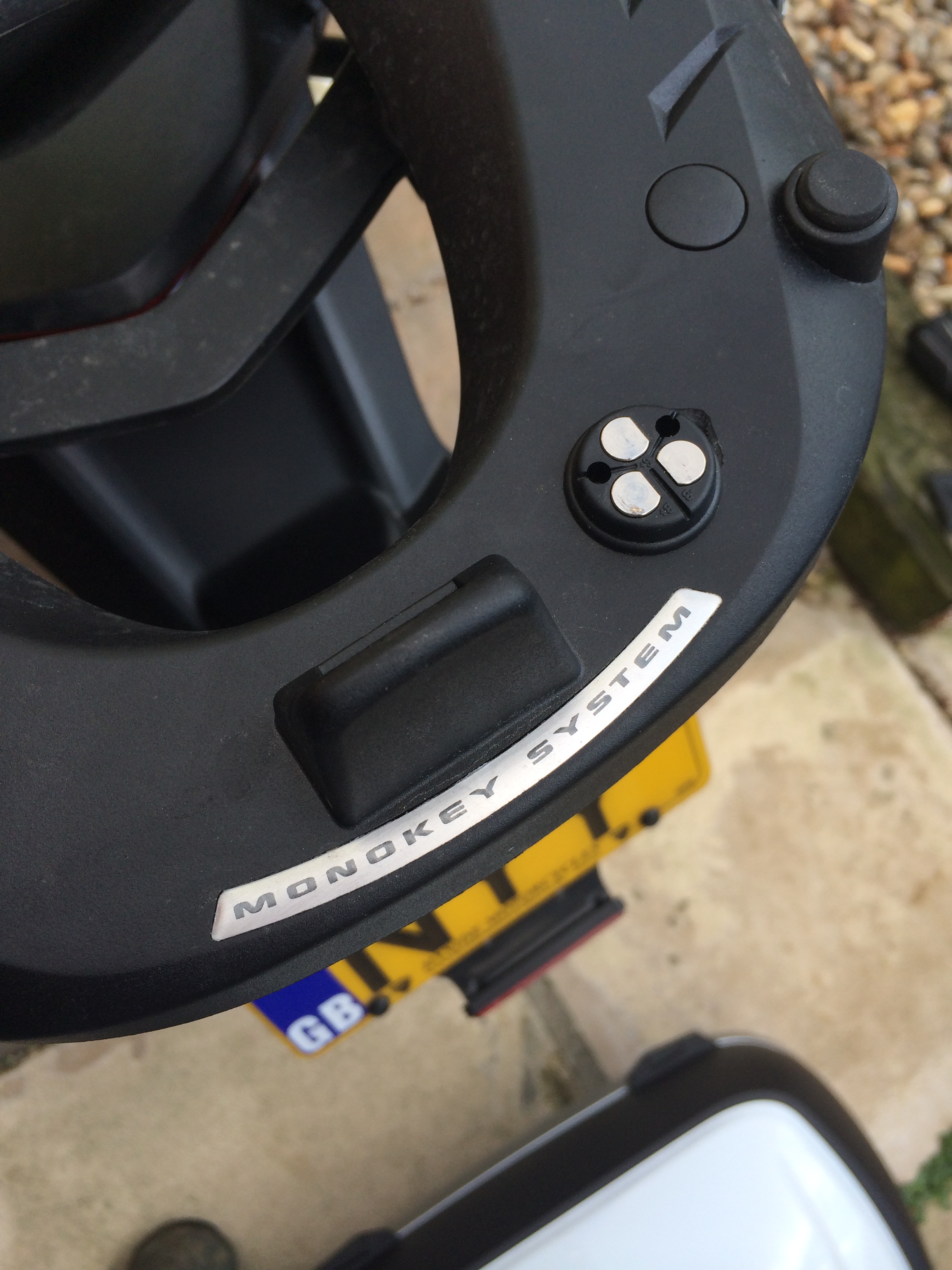

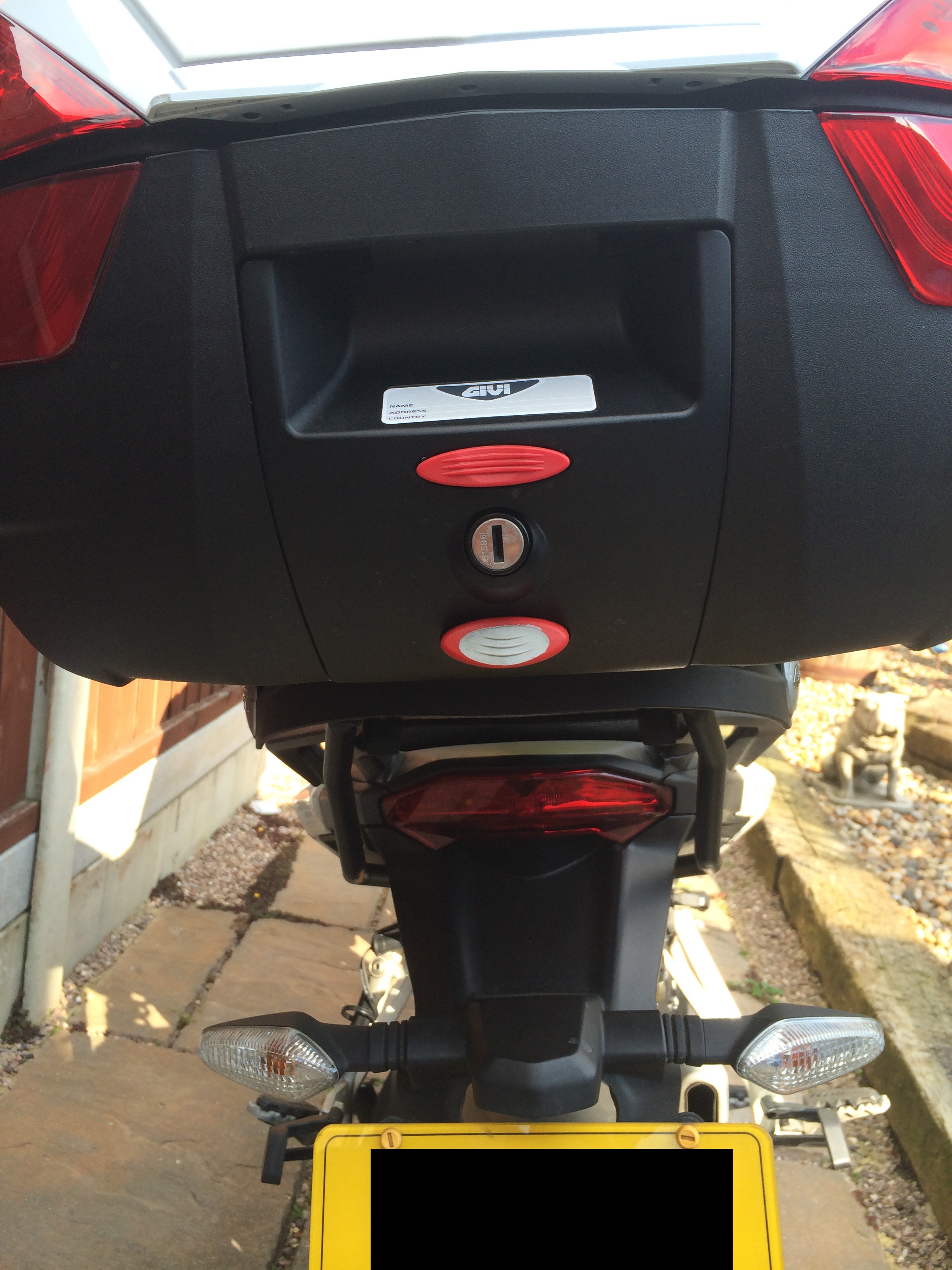

  6. Ok so sorry for the slow reply and the dirt...the bikes not really filthy it's a really good camera that picks up microscopic specks...;).

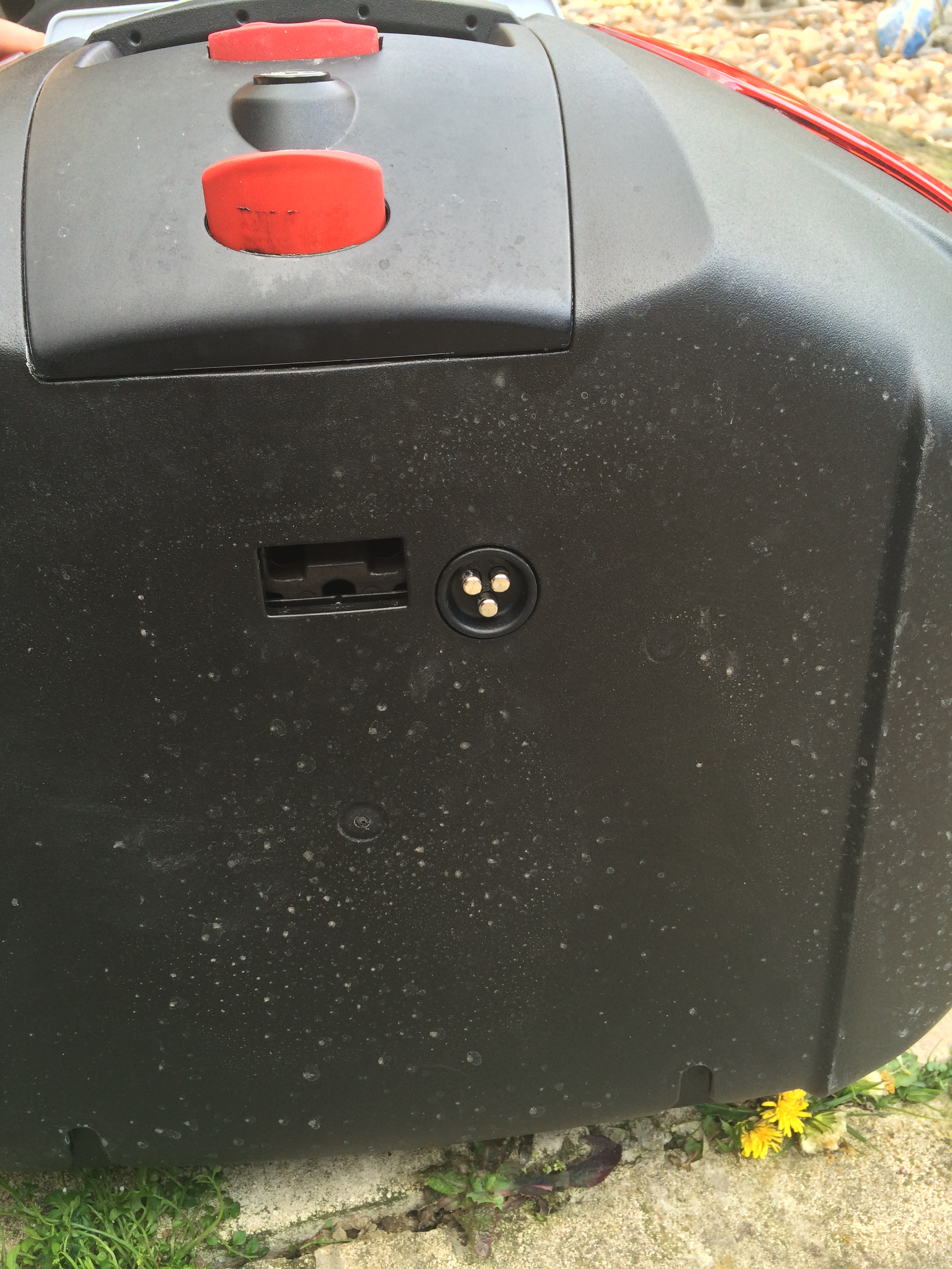

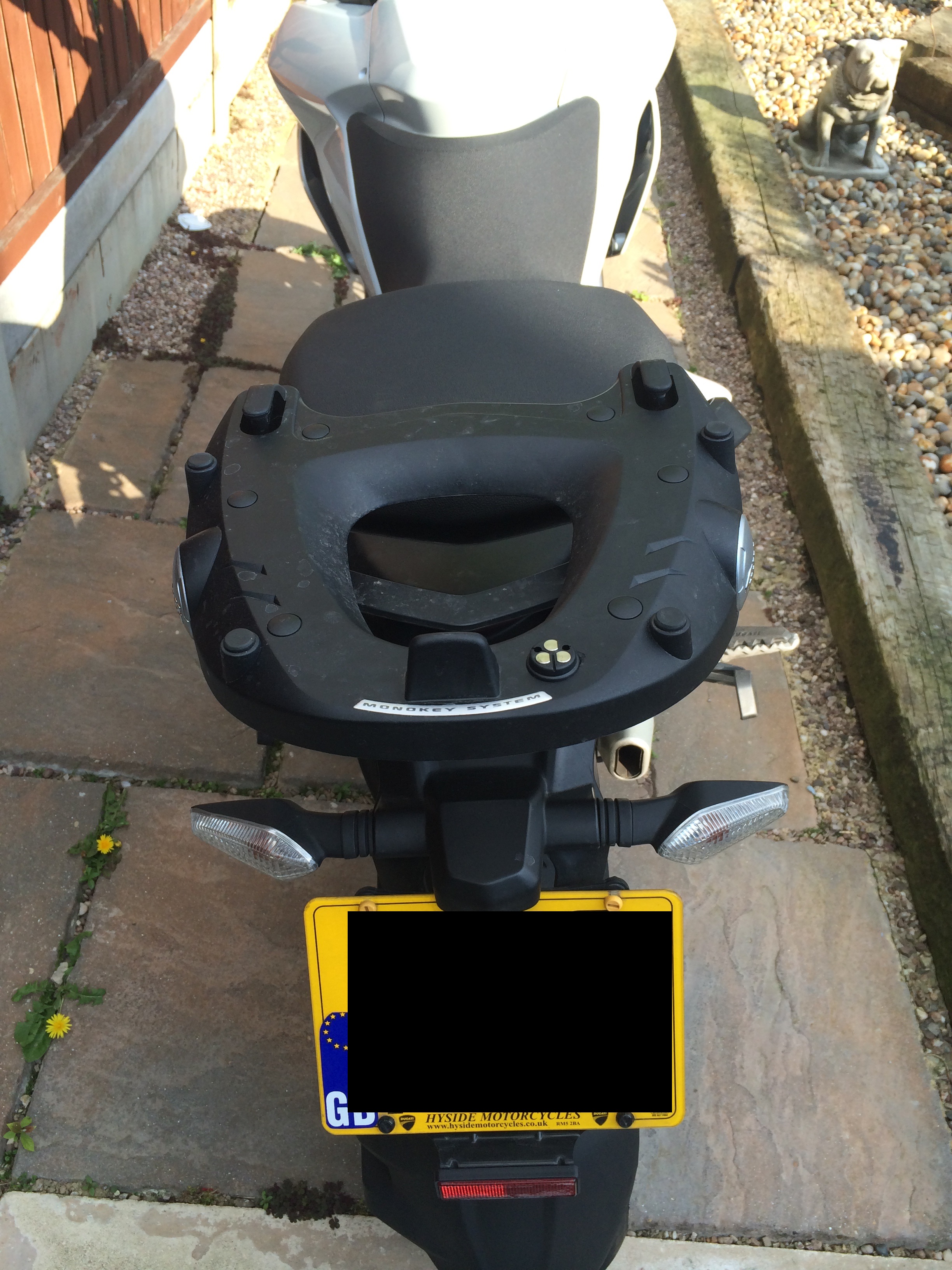

    anyway i've tried show that the lock stays in place so yes the box can be removed as usual. the bottom of the box and the rack have terminals that contact when the box is on (the kit comes with a cap for the sensor on the rack so it doesn't get ruined when the box is off)

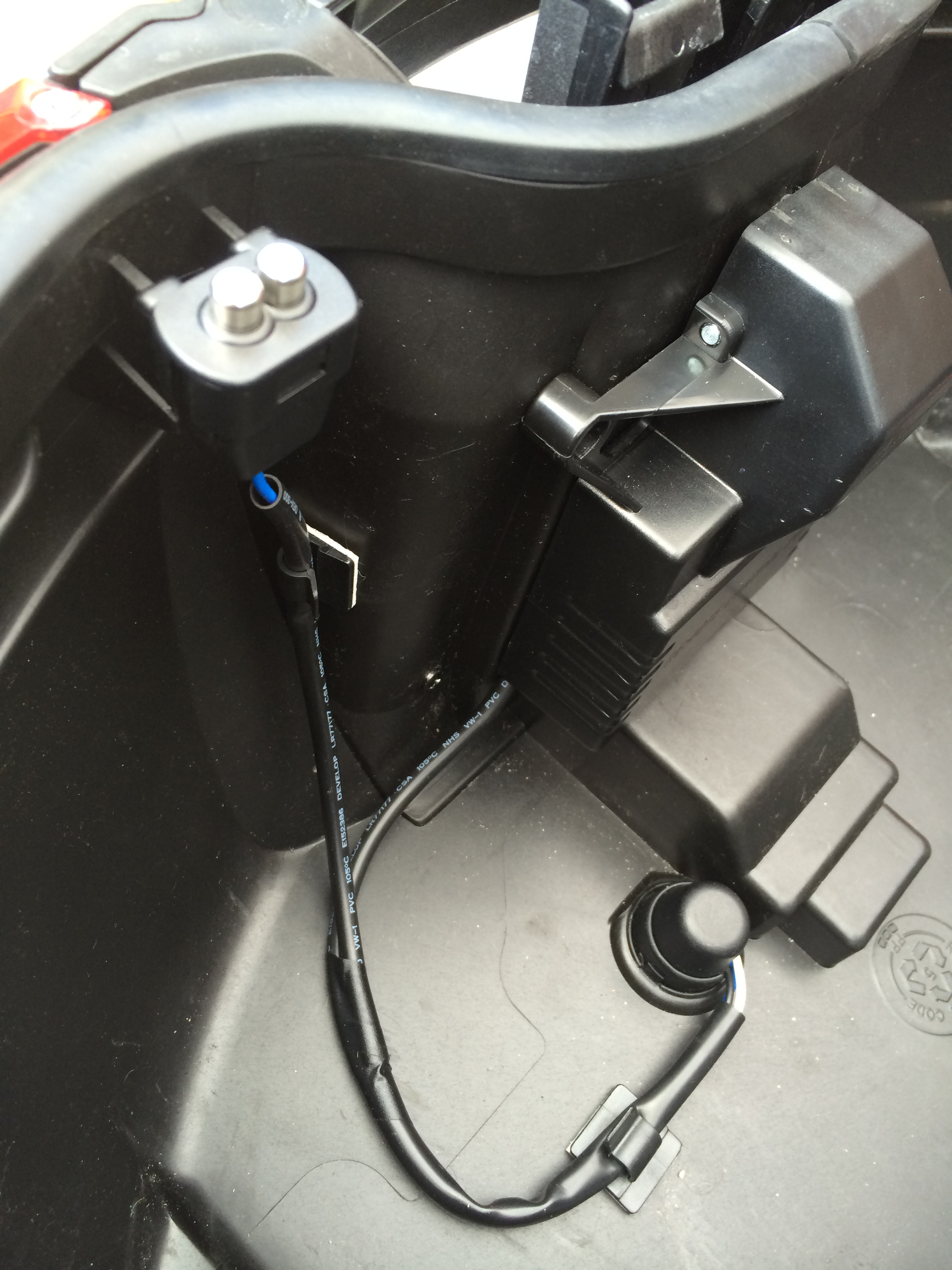

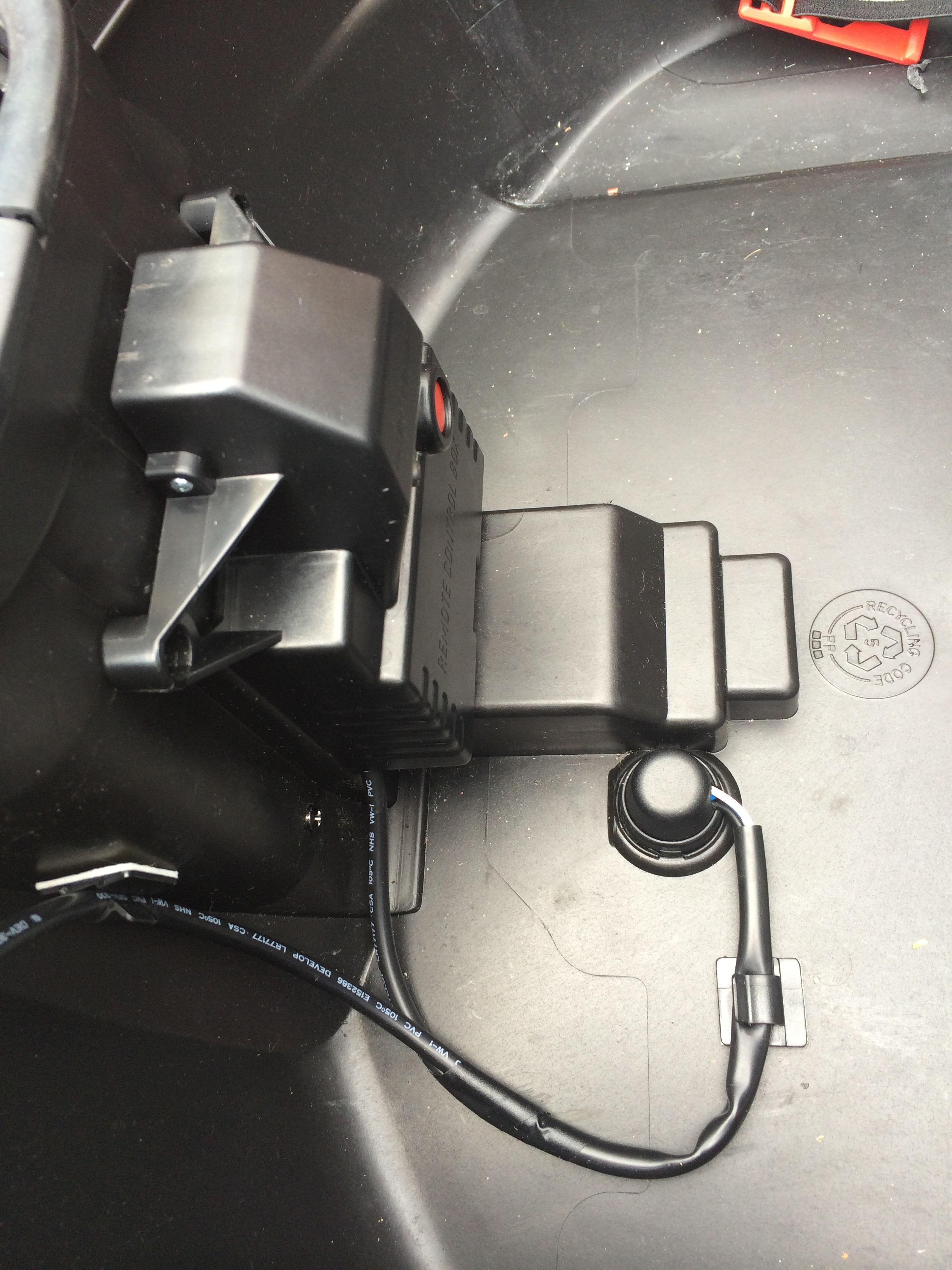

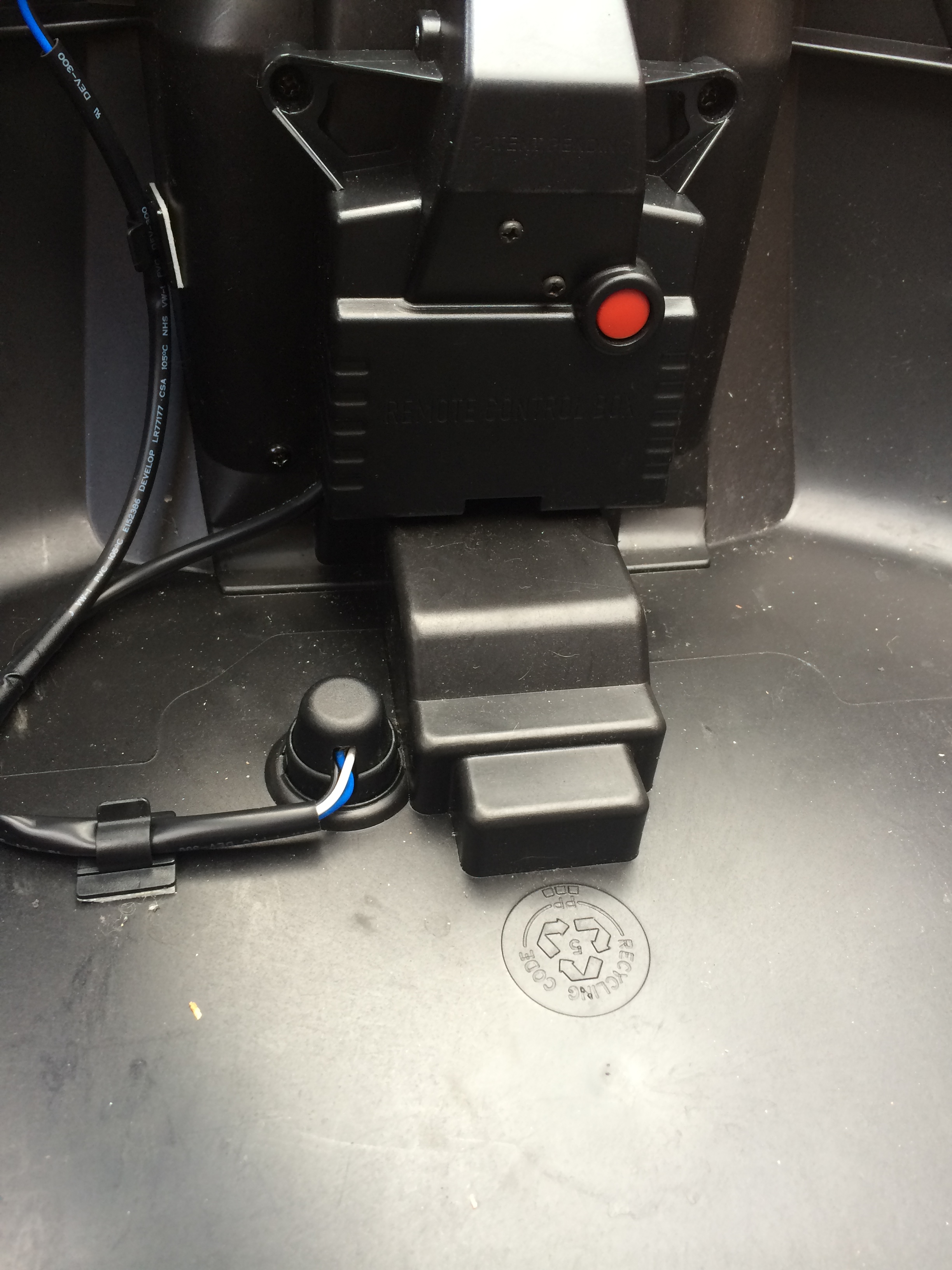

    Inside the box is the unit itself that in the case of the Givi box screwed straight on with just one hole to drill.

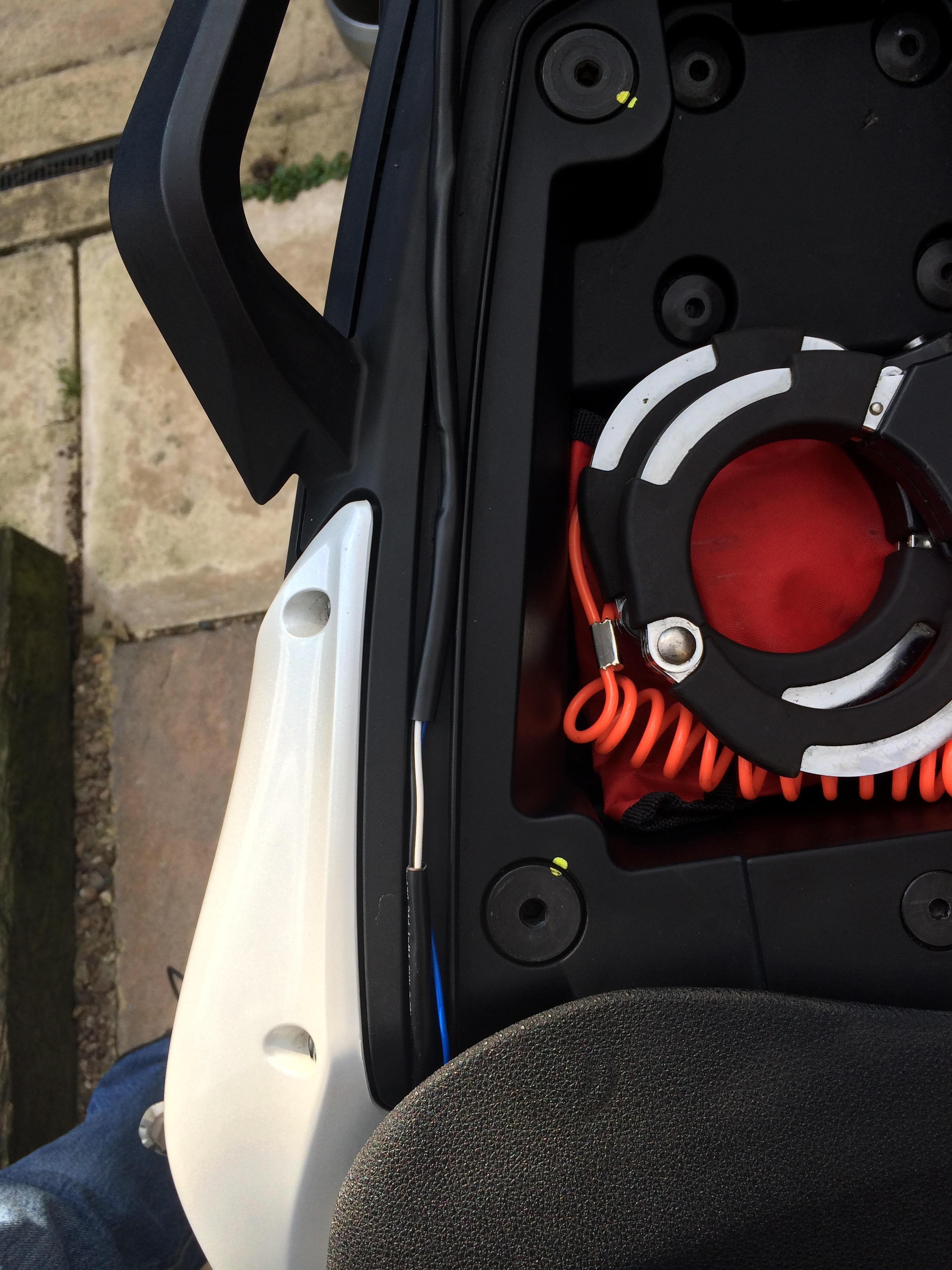

    I've run the wire up the grab rail. it's not great but with the hight of my rack this was prob the best option. I looked at running the wire into the rear light lens but because the rack sits up off the bike you wouildve seen wire running down. Still looking for an alternative though. I assume that the rails for the rack are hollow so i may try n run the wire into there.
    my tip..? be very carefull when you drill the holes for the contacts. As you can see the one on the rack is not great but the plastic is very strong but brittle.

  9. The unit's not too large. I can still fit 2 full face lids n 2 pairs of gloves in...just.
    Normally on the Givi boxes (I can't speak for the Ducati one) to unlock you turn the key and push the top button (to remove the box turn key and push bottom button). When the remote is pressed the box unlocks and the lid pops up, kinda like Central locking on a car boot. The remote has no effect on how the box attaches to the bike and you still need the key to remove it.
    The remote only throws the lock for the lid.
