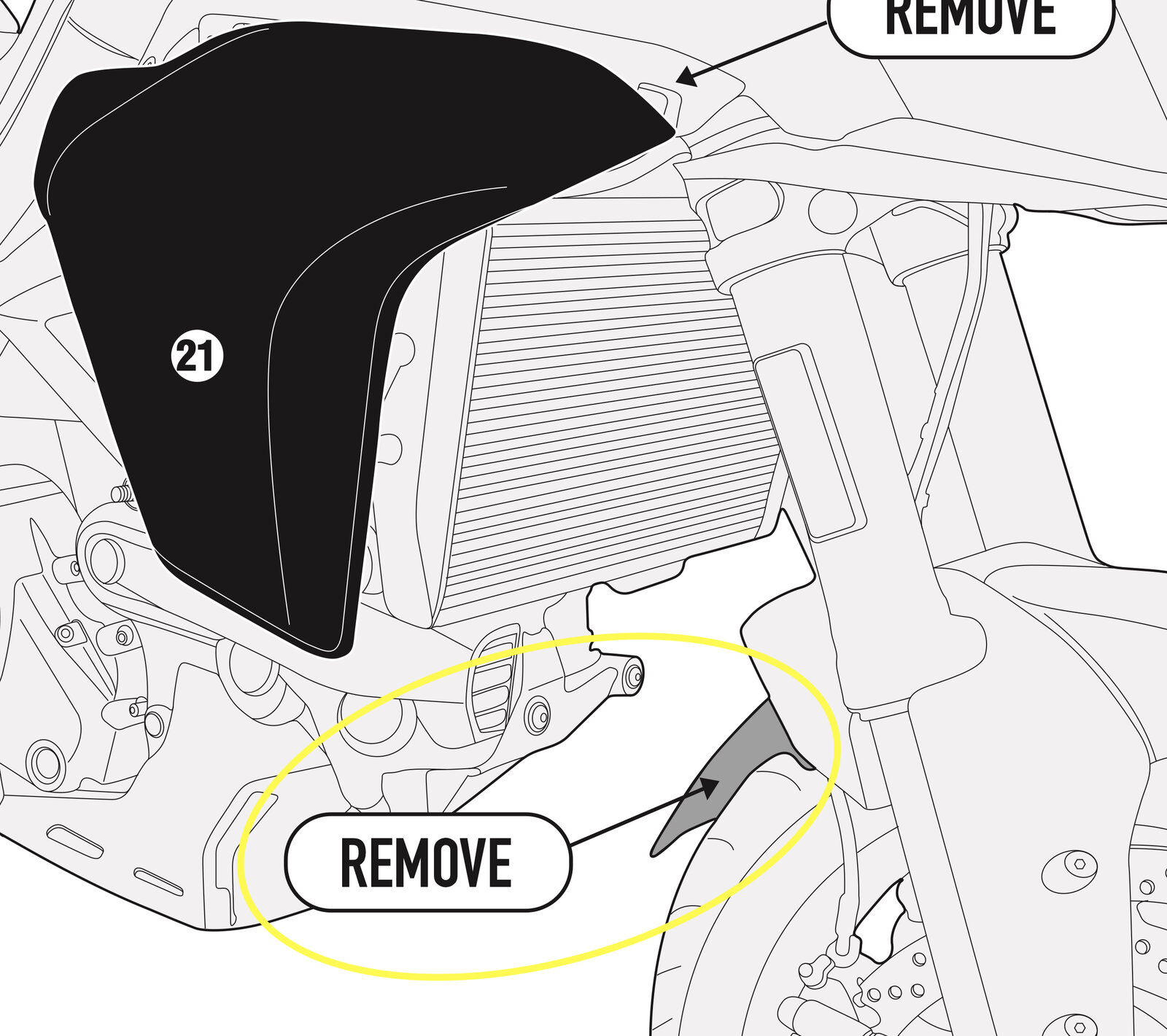

  1. who is running the on their 1260s?
    the installation instructions show removing the front fender extension ... but does not indicate if it can be reinstalled after installing the crash bars.
    does the crash bar lower crosspiece interfere with the front fender extension?

  4. I fitted these on my 1200 and yes the extension interferes with the bars to the point it rubs under heavy braking or even latches over the top , piss poor design from Givi
    I ended up removing the centre section and remodelling it to provide the required clearances ( I hit with a hammer)
    works a treat now even with an extender extender IYSWIM ?
