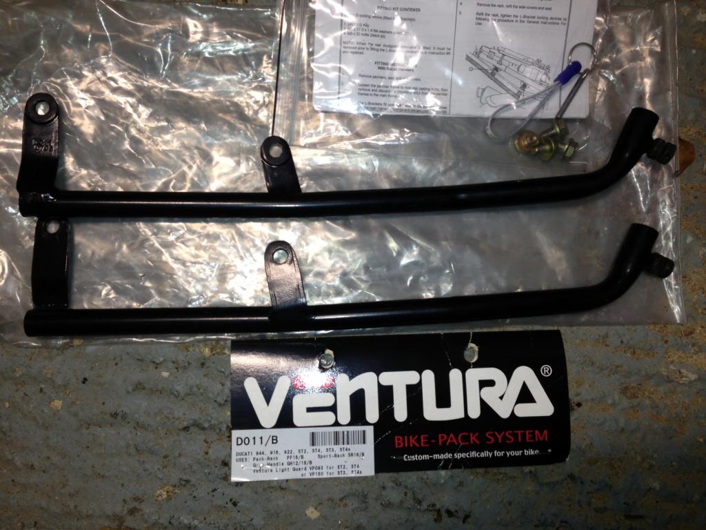

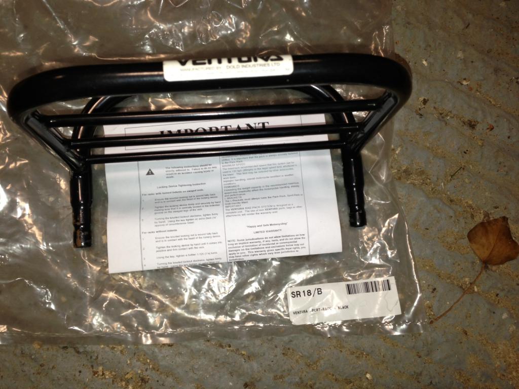

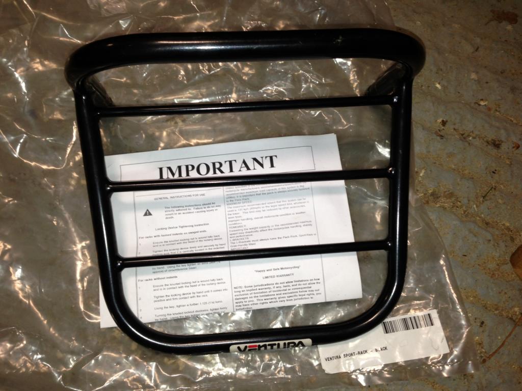

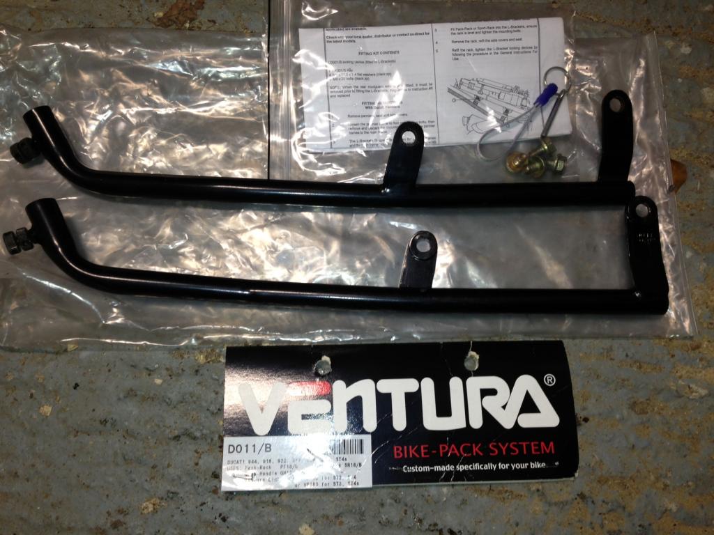

  7. Interested!
    Tried to find ad in Classifieds but couldn't see it!
  8. Here you go, link to the post:
    http://ducatiforum.co.uk/f20/st4s-new-parts-sale-18549/
    The brackets are the second from bottom of items listed.
    I didn't mention the rack but I do have it too (SR18 Sports Rack).
    New they cost over 130 quid. No price given so make me an offer, as a guide though I'm thinking around £75 plus postage.
    I can go take pictures for you if required.
    Update: here are some pics:
    l_bracket_1.jpg l_bracket_2.jpg l_bracket_label.jpg SR18_rack.jpg SR18_rack2.jpg
