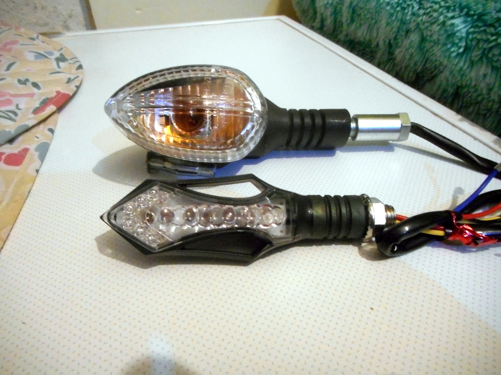

  4. There is a very long hollow nut that holds the rear indicator on. The wires run down the middle of the nut. They are not easy to unscrew as it is tight to get a spanner onto them. The top one is the standard Ducati one. DSCN0320s.JPG
  5. So I undo the long nut on the inside, whilst holding the indicator body? I can do it, but it just keeps turning and nothing is giving.
