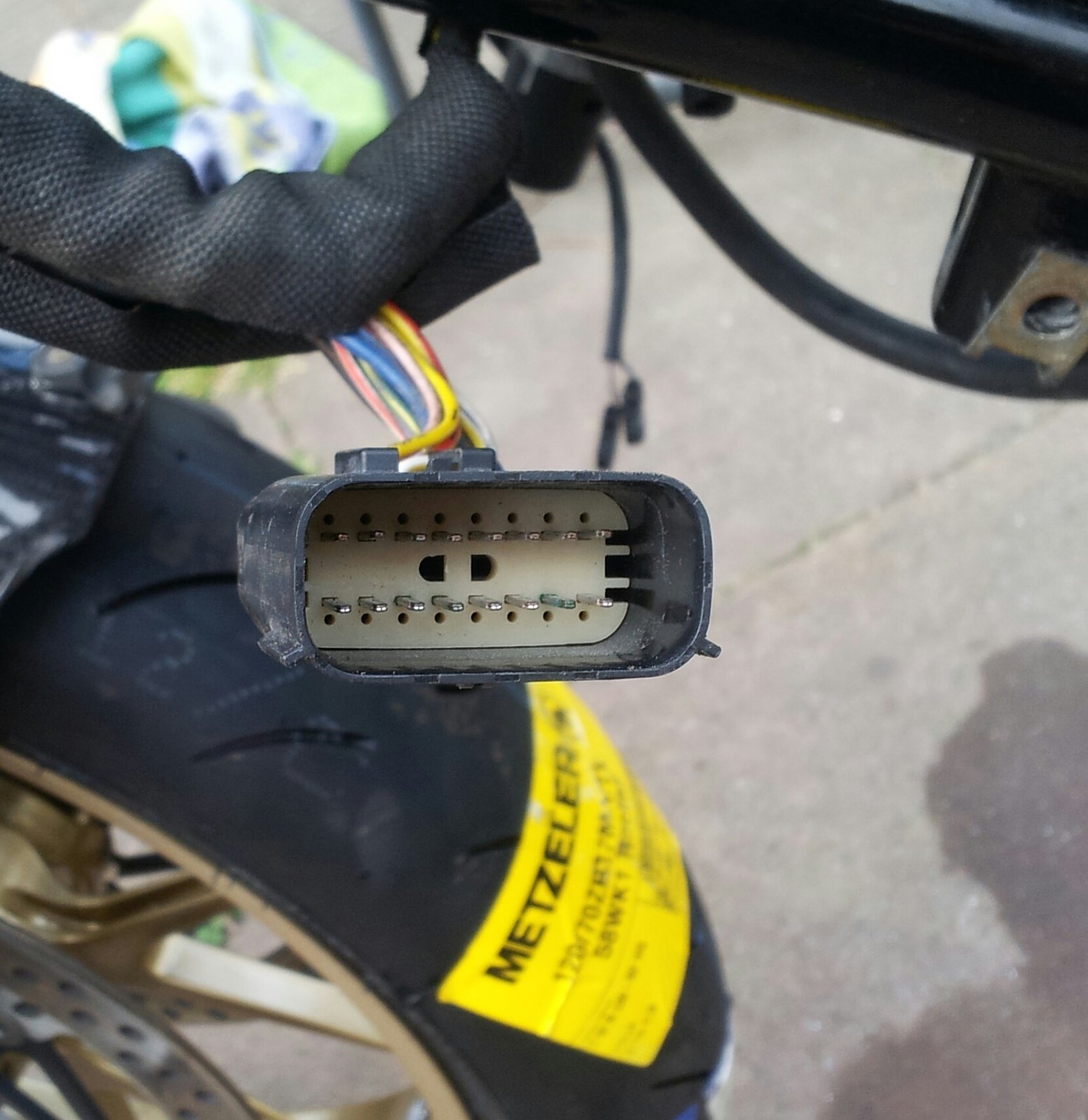

  6. You will need to look at the connector for the front/main loom.
    If it's a square black push together one, it's from a late bike. A round black/orange screw on connector is from an earlier model.
    I have seen earlier types on late bikes though.
    Below is the later type plug

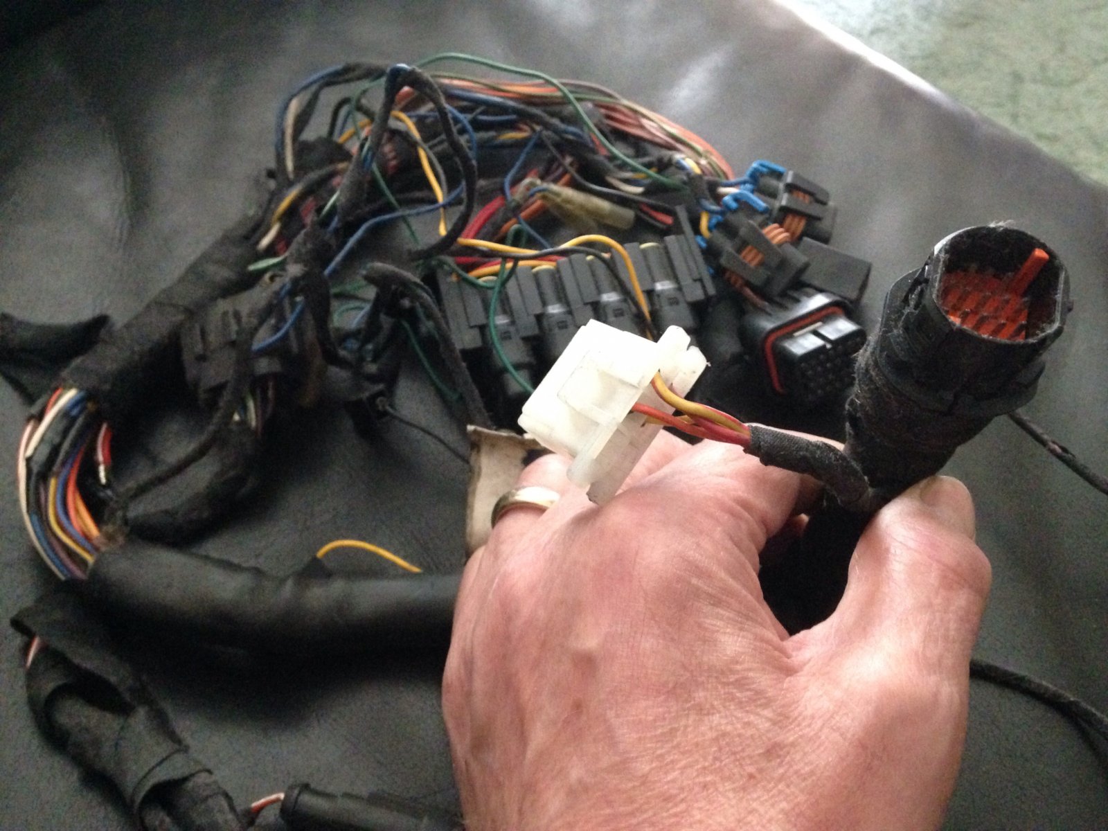

  7. I have spare front loom but the headlight connectors have been messed with. It has round connector. You are welcome to borrow for diagnosis.
  8. Mine was just stalling, none of the other symptoms as listed above. JHS Racing, Bristol had simply failed to set the TPS and fuelling before they attempted to mask that with a power commander.
  9. Many thanks for this offer. I have communicated it, via voicemail, to the Ducati doctor, so I hope he will tell me what he needs.
    Very kind and appreciated. I'll be back to you via PM if borrowing your loom looks like a good plan for him.
