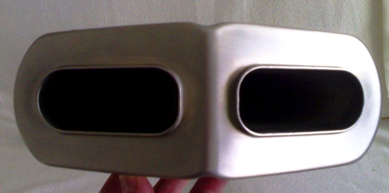

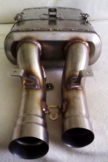

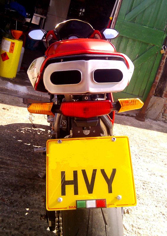

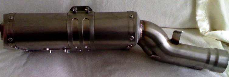

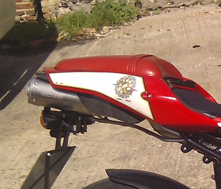

  5. Wildduck, you cant buy an assymetric Termi new anymore.....but better quality than Termi is SPARK...lighter too, fruity sound.......and available in full or assymetric guises.....

  9. Thanks guy for all your help ..XxAnthxX your right i don't have the money to re-map and stuff should have put that lot on top of the mortgage i just got..lol..final_edition thanks for the heads up but he's wants £400 + postage still a bit rich for me and it has a cracked hanger on it !nogaromill999 thanks bud not a bad looking can that how much do they go for and is the can a straight fit onto OEM pipes and ECU not worried about a full system..
  10. The assymetric system fits straight onto std pipes but you will need the de cat header for the front cylinder....if you werent aware, the std can contains the cat for the rear cylinder, so get rid of that and you have to get rid of the cat for the front, which is in the pipe......you have a choice of stainless can or Titanium...whats your poison?
