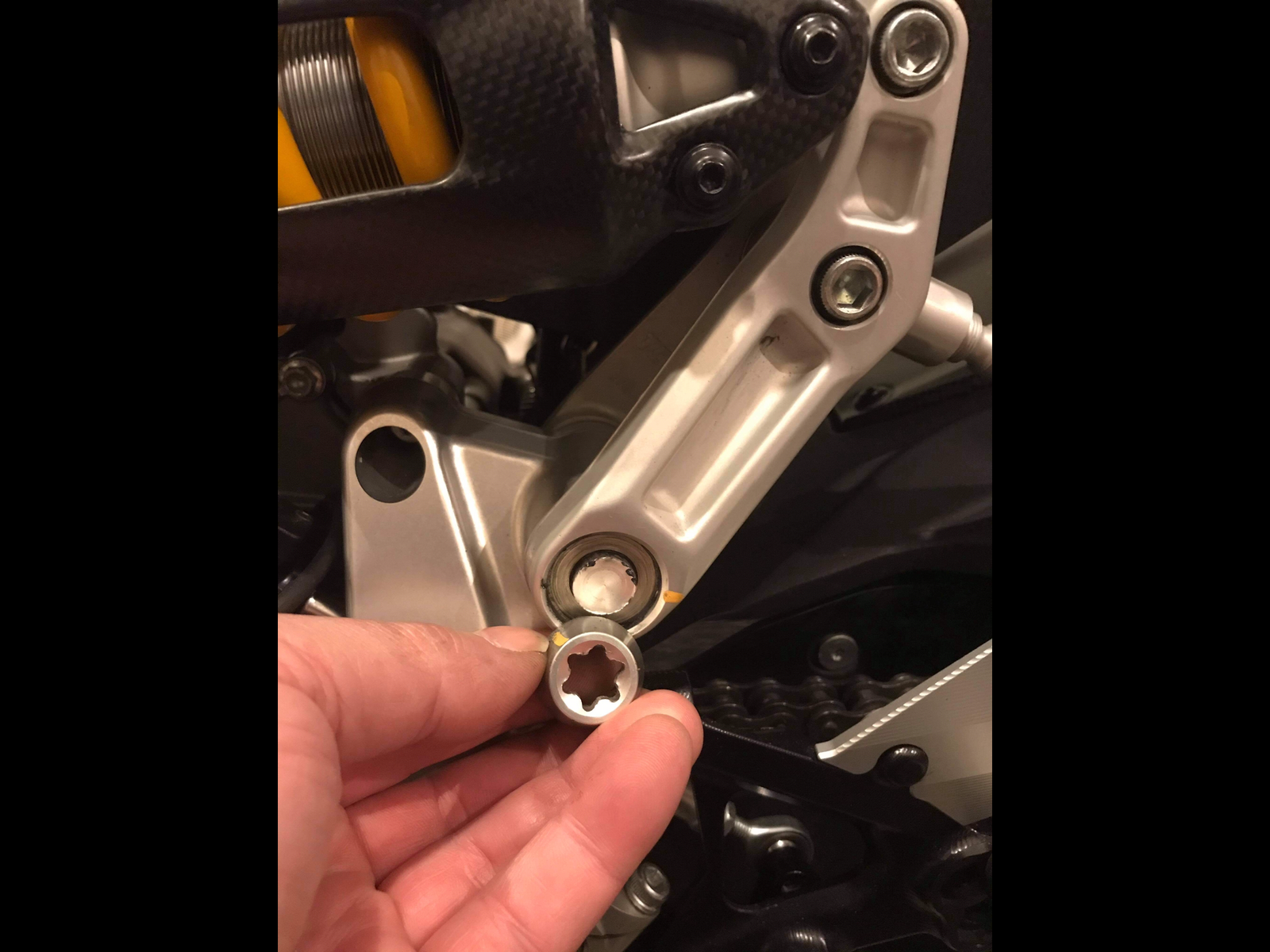

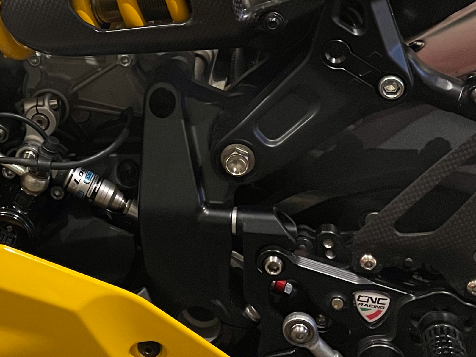

  2. Yep, all wheel bearings on the 899/959 are sealed. Haven’t done the steering head bearings yet but have done the rear shock rocker. The manual states 60Nm for those two torn taper head bolts. They’re nowhere near that as only made of alloy. A good mod here is to use an M14 Ti bolt all the way through and a nyloc nut on the back.
