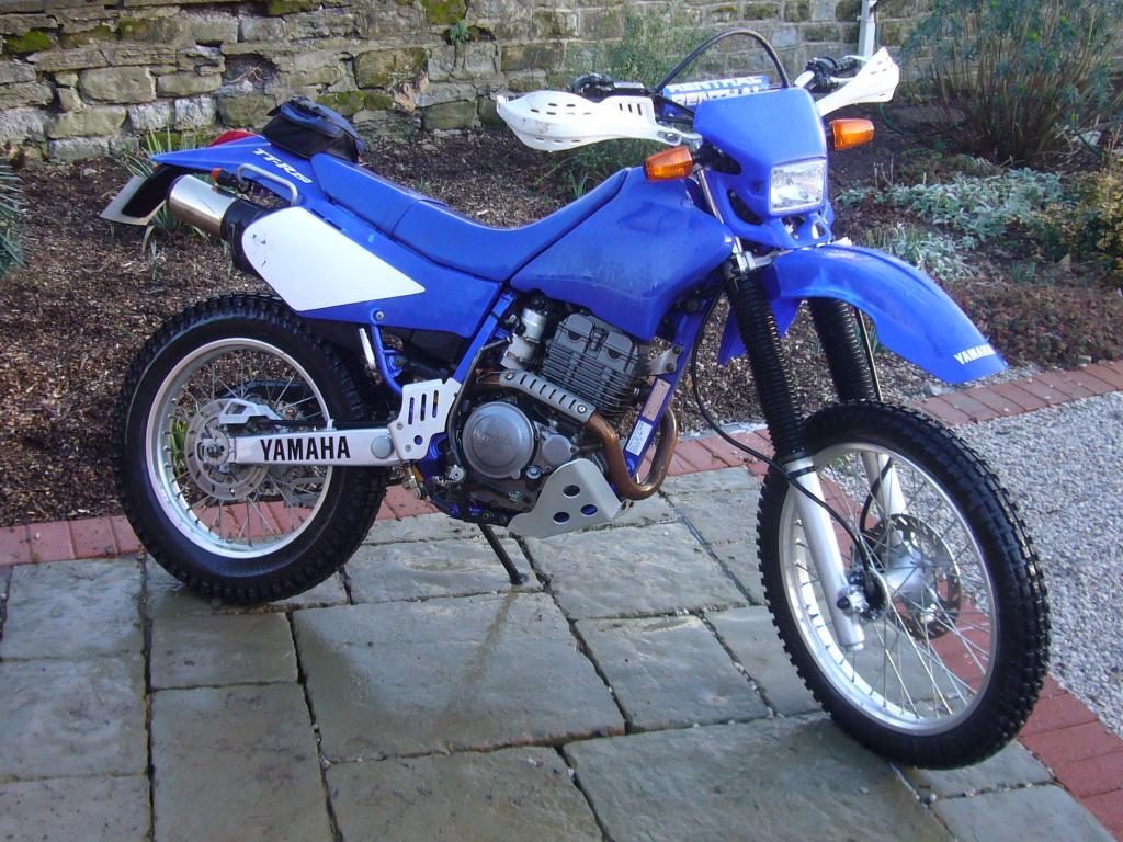

  14. I have a Yamaha TTR250 and I can't recommend it enough. It is totally bullet proof, nice and torquey, not too tall for me at 5' 8" (with a lowering link and cut-down seat), enough power but not too much to get yourself in trouble, and light enough and easy enough to start (electric and kick) when you do :tongue:
    Most importantly it is very forgiving and easy to ride - important if you only ride off-road occassionally like I do.
