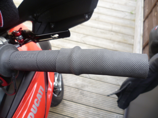

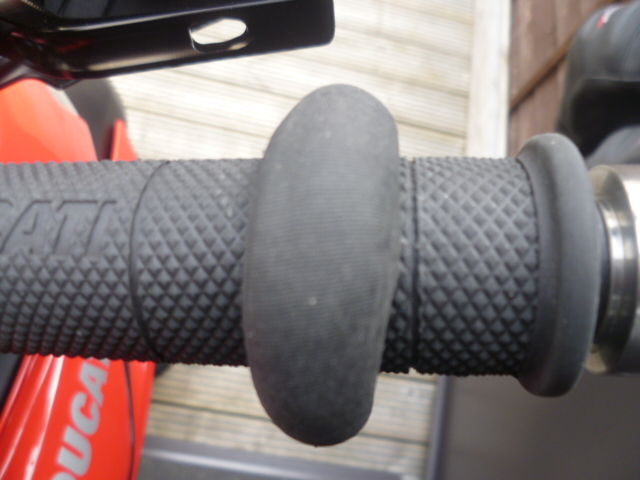

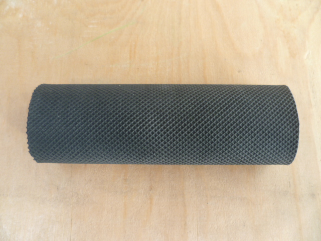

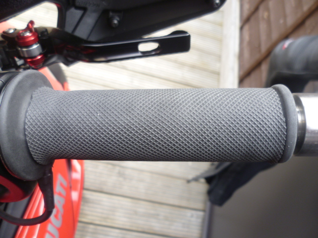

  1. Well I think I've found the perfect solution for the stock grips.
    Like many others I found the OEM grips a little skinny and quite harsh but I didn't want to cut them off and possibly do damage to the heating element underneath, so I've tried a few methods but the best and cheapest was a simple CRICKET BAT GRIP, approx £3.00 off ebay
    Not only does it feel 100% better (my opinion) but will also stop your stock grip from wearing as others have described. The heat comes through no problem too :wink:
    Not difficult to fit but I took a few pics to show how I did it :upyeah:

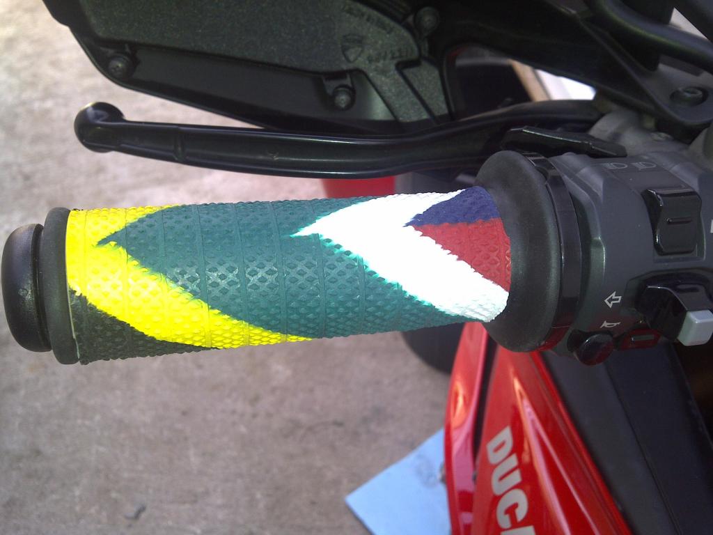

  7. My patriotic version!
    With thanks from the worlds best cricket team
    :upyeah:

  15. The grips are no longer on ebay but if you search amazon for
    READERS DELUXE CRICKET BAT GRIP - BLACK
    they do come up £5.50 posted
  16. Got it and fitted works well
