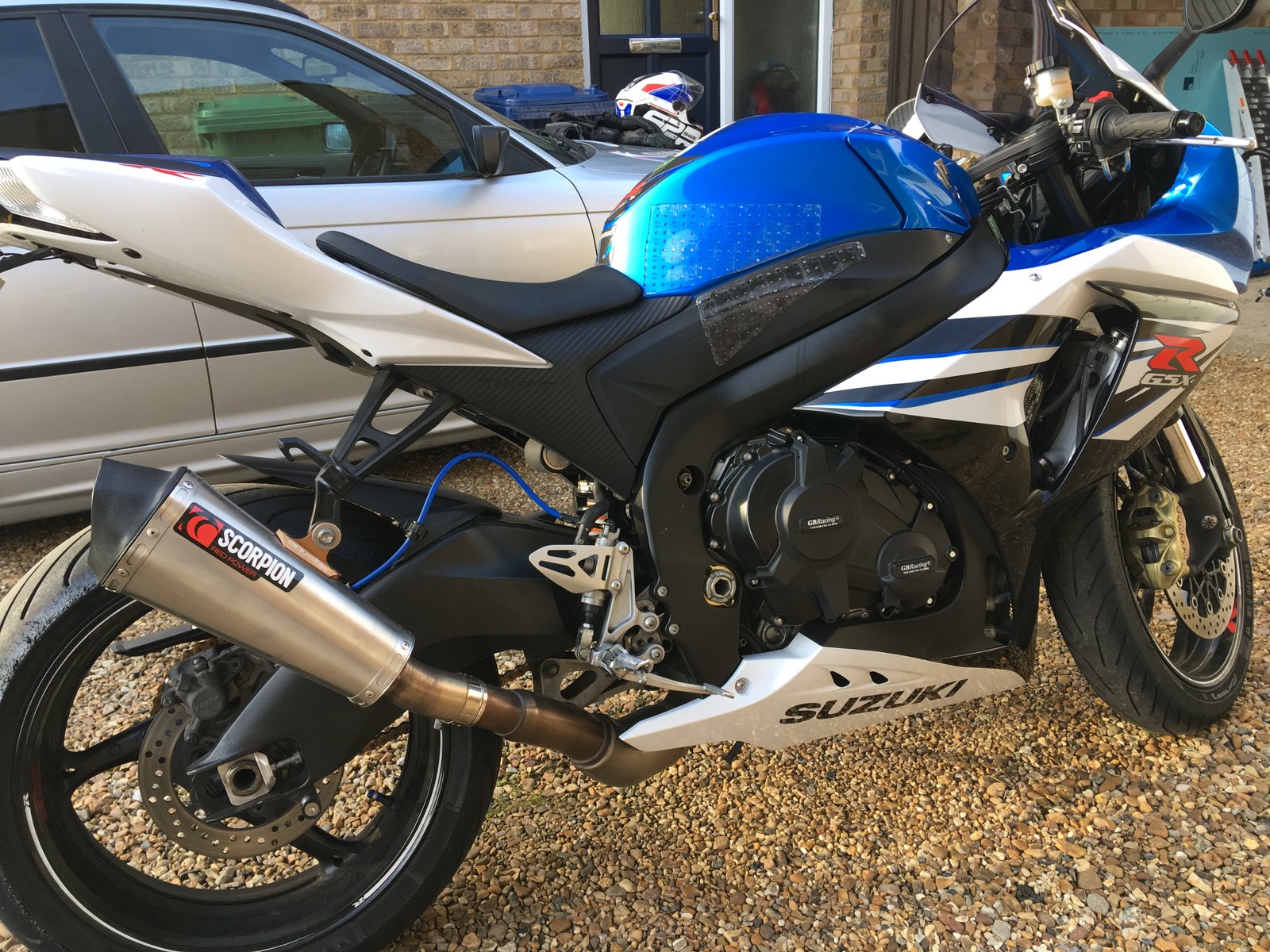

  1. Purchased this last year to turn into a track bike after the reluctant sale of a 1299.
    So far have added venhill braided brake lines, Healtech quickshifter, DID chain and sprocket 1 down at front.
    I was tempted to sell to get something like a K5 instead but looks like I may be keeping for a while so...
    I wanted to get the suspension set up for me and asking for some advice really from those in the know.
    Is it more beneficial in the first instance to go to somewhere like MCT and get the suspension set up or to do it with a company at a track day where they tweak throughout the day.
    Cheers Lyndon

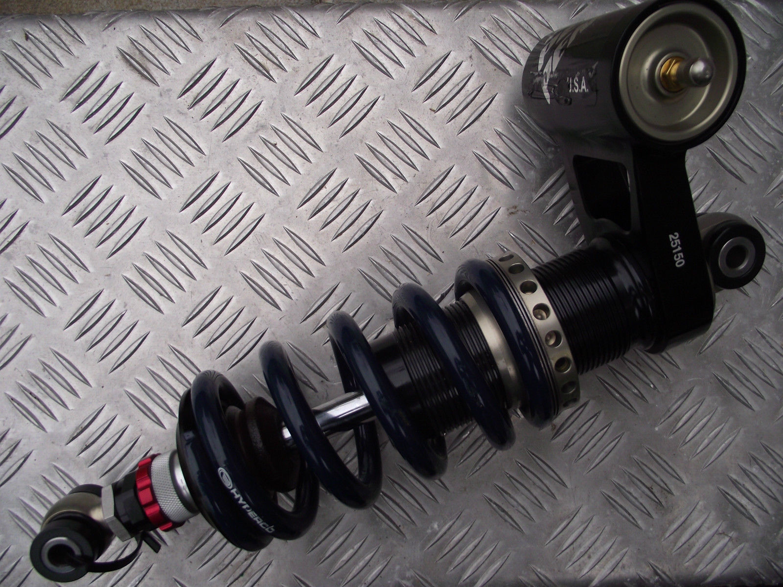

  2. What model is it? I've got a beautiful Penske Shock - think it fits a K9 onwards but would have to check...
  3. Mmmm, might fit :)
    It's better quality than an Ohlins unit, that's what the Ohlins tech who serviced it said anyhoo...
    If your interested I'll check fitment and get some pictures at the weekend. :)

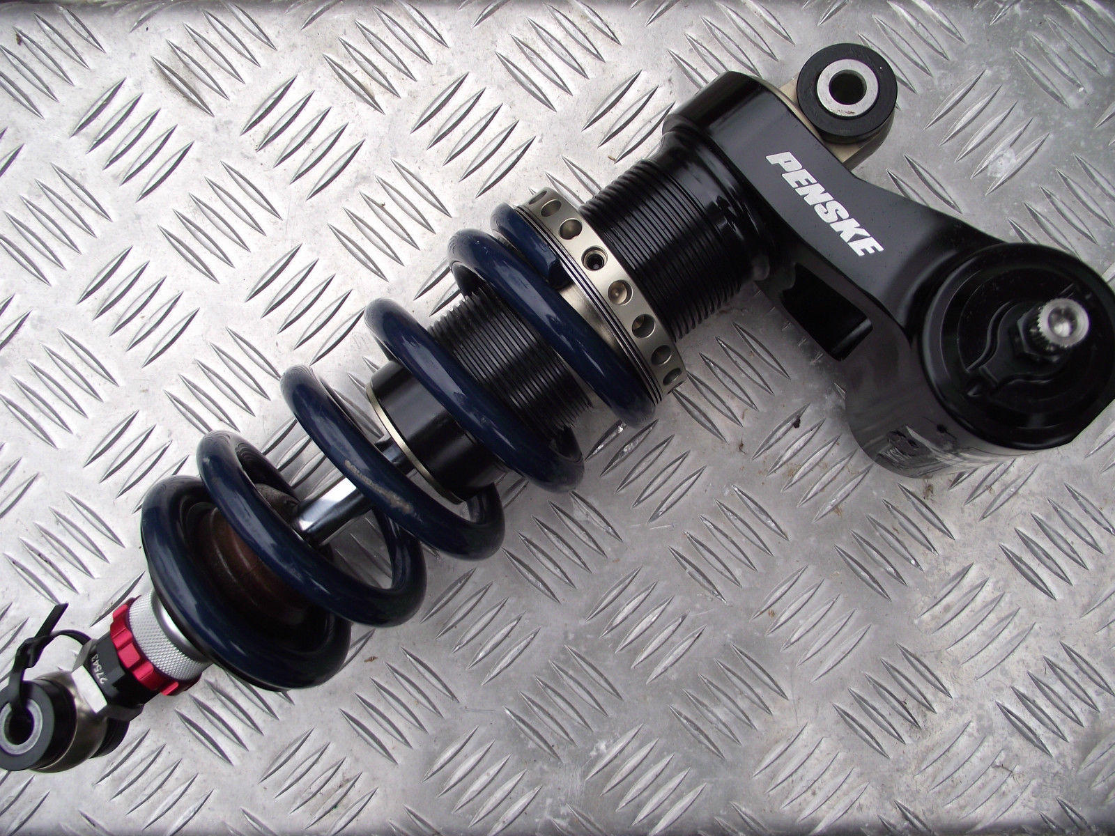

  4. Found some pics...
  5. What’s the retail on one of these PM me and il have a look at options re the set up etc cheers
  6. Be a good upgrade if it fits mate.

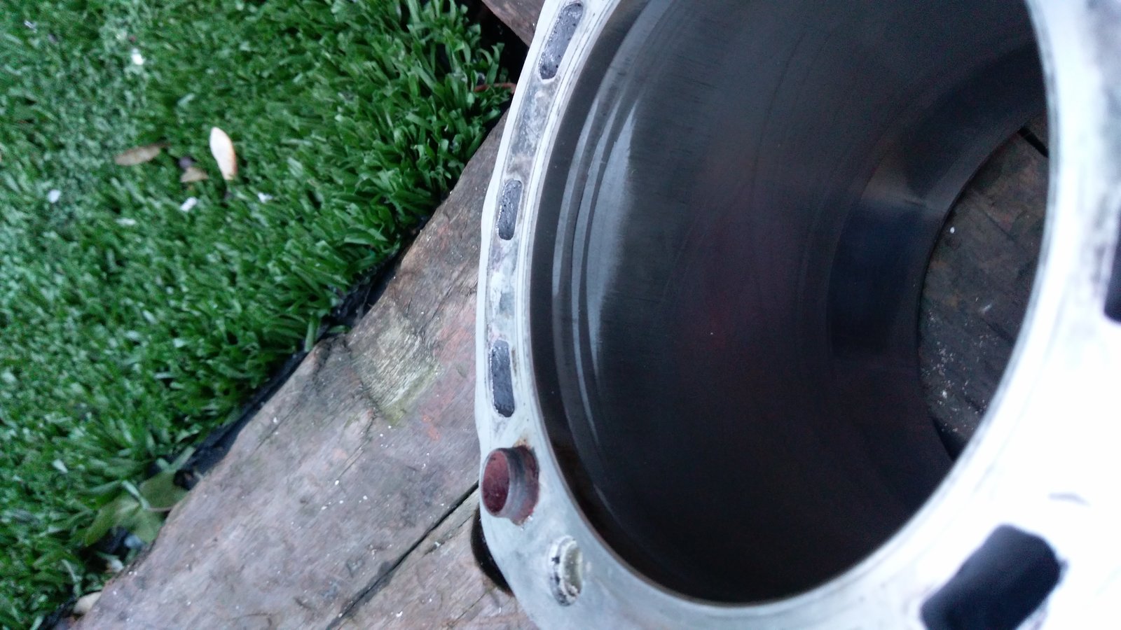

  7. I'm getting my forks service by 100% suspension as they also do track days. That way I'll get the guy who rebuilt them dialing them in.
    Remember Rockingham in October? vertical cylinder on my 999 went belly up. Whoops.

  18. Scored a piston.
    All repaired. Now going to retire as a track tool and be used on road and maybe the odd Ducati track day. Will fix her up nice.
