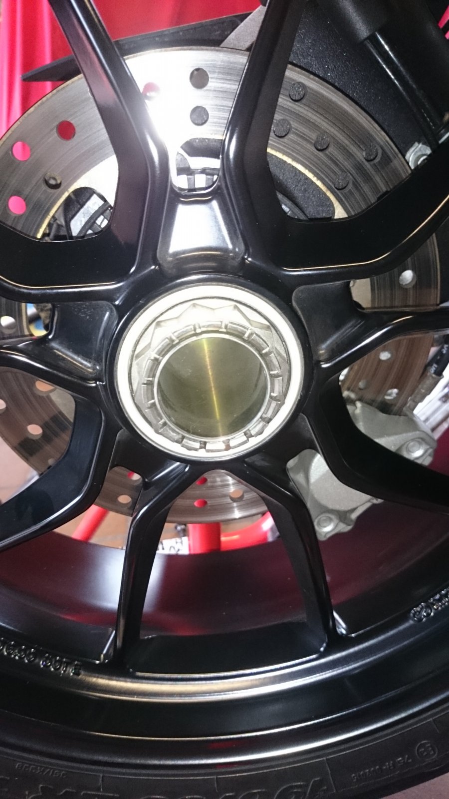

  1. Hi all can u tell me what size is the rear nut to remove the wheel on a 2013 gt please
  2. 55mm bi-hex, but id recommend getting a 3/4 drive socket and a long breaker bar, getting that nut off with a 1/2 one is like moving the earth
  3. I used the 55 mm 3/4 socket with adapter to my 1/2 inch breaker bar. With 4 foot length of pipe it came off easily. Rear brake tied down.
