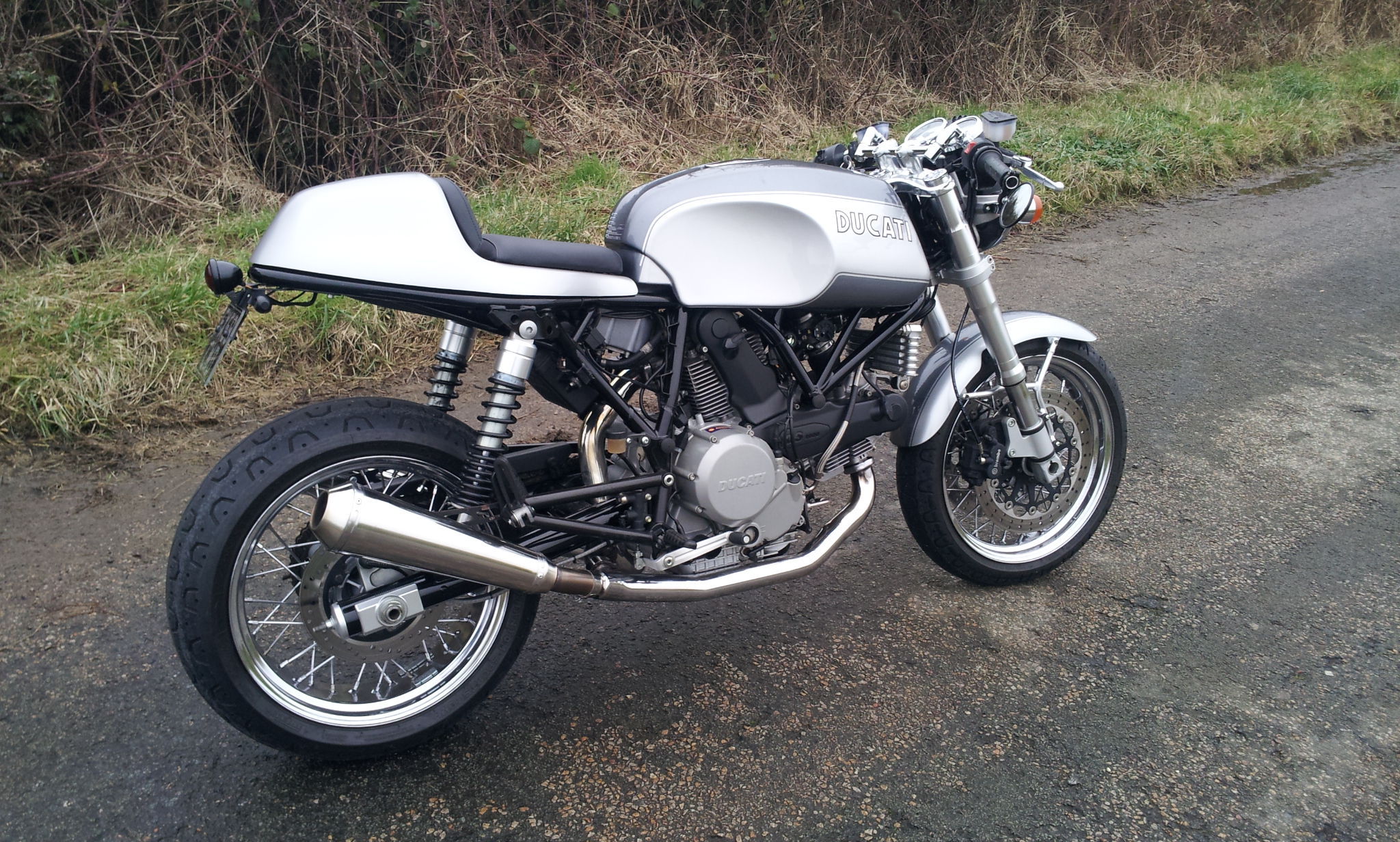

  2. The sport 1000 seat wil fit but the GT tank is shorter so it will leave a gap between the two.
    As far as I'm aware the cowl will fit straight onto the GT and give you the same look, they are difficult to get though and as a consequence go for stupid money.
    I think you can get a fibreglass one but cant remember where i saw it now.
    You could get the diopa seat unit but that may have the same fitment issues the OE sport1000 one does.
    Clip ons are easily fitted with the usual caveats of refitting all of the wires and lines etc. back into a smaller space, possibly needing a new top yoke too.

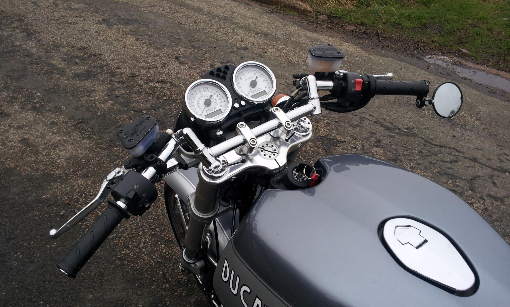

  3. Red Max which is Steve Hilary ex Dr.Desmo/Moto Rapido can turn a monster into SC lookalike using their own tank and bits .
    You could probably build your own better spec'd bike cheaper.
    New ducati tank fitment - a set on Flickr
  4. Thanks, great project with the Monster. I have always liked the concept of the naked Monster but I have also always looked at it as a girl-only bike because of that roundbacked gas tank, it reminds me of a Nissan Micra, which was also made for girls :rolleyes: If you give it a straight-backed tank and a café seat, good things start to happen.

  5. mmmm thats nice. :Snaphappy:
