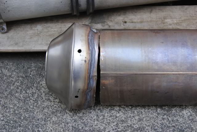

  1. so firstly I drilled out the pop rivets
    that hold the outer cover on
    then with the outer cover removed I then use a dremel to cut the end spout
    off the inner baffle pipe
    now that I have removed this you can see another restricting baffle
    that goes from the end spout to in inner baffle pipe
    again the drill and dremel comes to the rescue to remove this.
    so now this is all the parts you are left with now that the can has been fully gutted
    the baffle inner pipe(which weighs a ton) can now be thrown in the bin...look at all that restriction
    and this is what the can looks like with all that rubbish taken out(note the smaller inner pipe where the cat used to be)

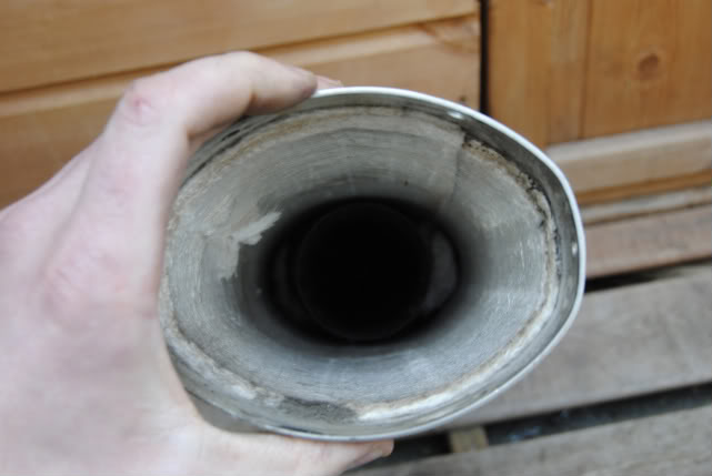

    so now when you look in the end pipe you see this
    sorted, now you have some phantom brand cans :upyeah:
