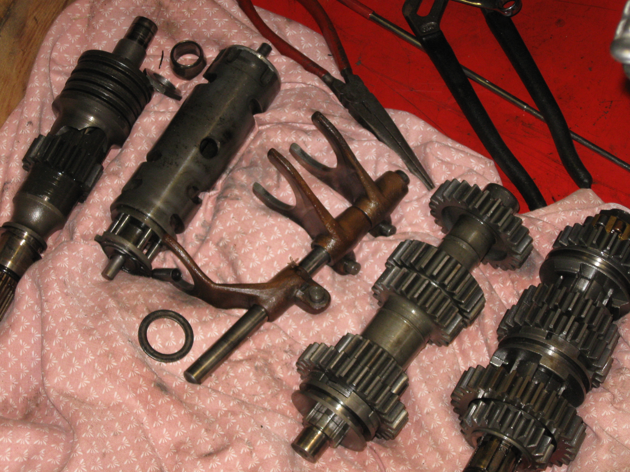

To minimise mts mileage .I thought I would get my guzzi 1100 sport 1995 carb model back on road after some 80k miles, however clutch slip? Caused me to investigate further? , engine out to inspect clutch, plates ok, so onto pushrod mechanism, oops wear/breakages, led to examine gbox, input shaft wobbly! !, gbox apart , = 3 new bearings and also new layshaft due to spline wear, web searches for best! Prices for new parts , uk and europe , large difference? , sourcing used layshaft, chris , west sussex

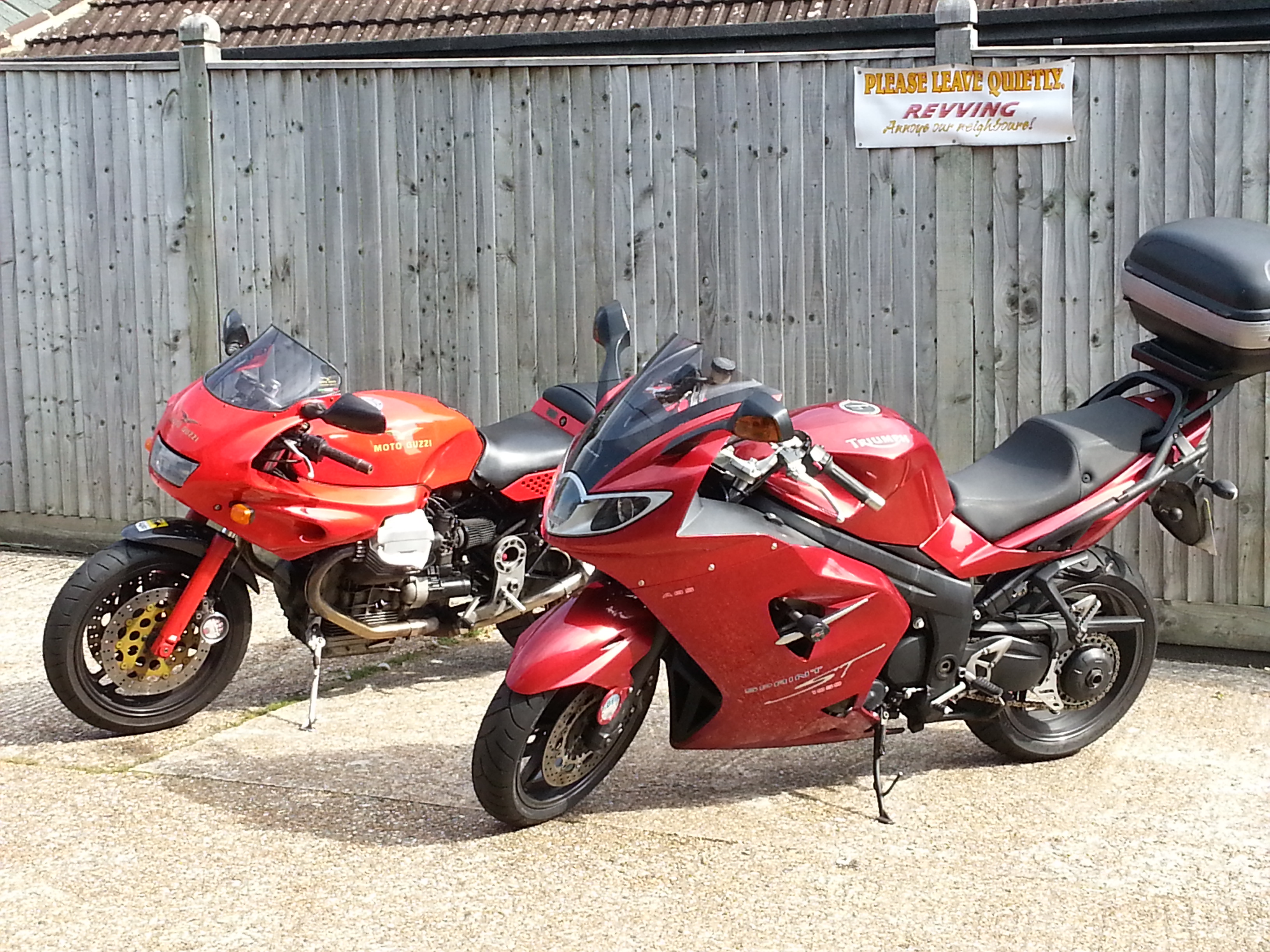

all done , thanks to stien dense , gutsibits and friends and family for help advice , new bearings ,seals , all back and first 100mph was scary , wil it be ok,seize etc. New master cyclinder just fitted and tied up to aid air bleeding. NEW ish bike now to ride on non mutlistrada days
Looking good I'm all too familiar with that bottom photograph. Currently waiting for some odds and ends from Stein Dinse to get started assembling mine
