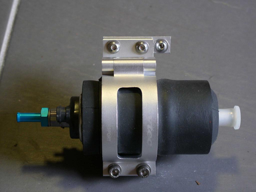

    That pump does not look a million miles away from the original fitment on the Daytonas and Sportis anyway. On these the pump hung underneath the front subframe of the spine right at the front of the bike.
    If it's too big then I guess you have 3 alternatives
    1) Make a new bigger bracket to suit the new pump
    2) Relocate the pump. Will involve some more fiddling and more fuel hose
    3) Give up on that and get summit like the Pierburg (expensive)
    I would make sure the pump has adequate cooling air around it and some form of vibration protection, electrically you have no worries the original rubber sleeve is for vibration protection only.
    Here is how I am mounting mine when the time comes, an e-bay bracket at about £35 and then cut to suit.
    If I can help any more just come back
    John
