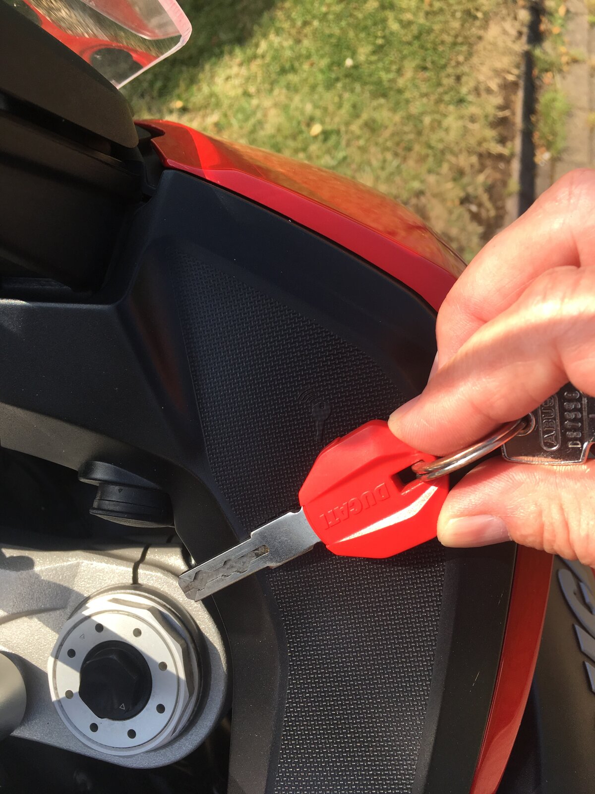

  17. Sorry to hear this - the red key will unlock the bike & fire up the dash without having to enter the pin if you hold it here for several seconds:
    I had to shop around several key cutting shops before finding one who would cut a Ducati key.
  18. Sorry - I meant to add you press the grey unlock button below the start button at the same time!
  19. Thanks buddy, top tip with the red key! I didn’t realise that
