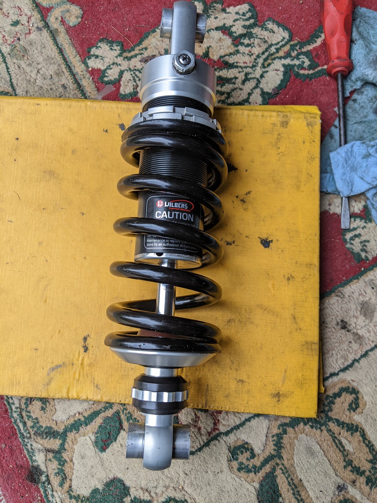

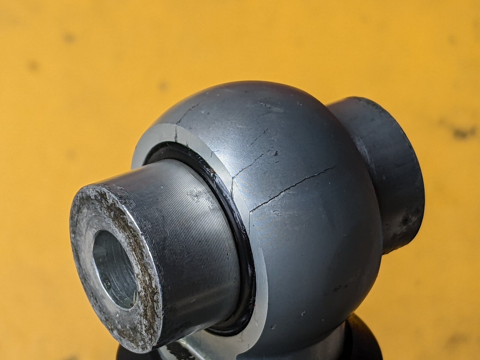

  1. As per the title, I have just noticed a couple of hairline cracks in the bottom eye of a rear shock absorber :(
    In the bin or what - all opinions appreciated.

  4. It's a Wilbers:
  5. It doesn't look that old? Have you called Willbers?
  6. Needs a new bottom. Dump the gas. Undo the broken part and replace. Fresh gas and jobs done. The question is, how did this crack in the first place.
  7. Oh my it is old.... about 6 years & 40k miles old in all weathers. I first noticed some play in the swingarm and after a clean & a shock service it was found the bearing had pretty much collapsed & was replaced. And it was probably in that collapsed state for a good few miles....
    I'm pretty damn sure the cracks weren't there when I picked it up and I'd I like to think I would have noticed them straight away. Since then, 2 weeks ago, the shock has just sat on the garage floor with the occasional lever from me just to see the available movement the bearing can provide.
    Can hidden cracks/weaknesses 'grow' when put under new/more stress?
  8. "...Can hidden cracks/weaknesses 'grow' when put under new/more stress?.."
    Most certainly YES! It's how they grow in the first place...
  9. That’s fooked.
  10. Now don't beat about the bush Ricky.... just give a straight answer :)
    With hindsight I reckon I ran it with a knackered bearing for too long.... ho hum. I noticed a quiet squeak when bouncing the rear that disappeared with a squirt of WD40. This was probably when the bearing started to fail. As it got worse it introduced too much play which in turn placed too much stress on the eye casting causing a failure point.
    Then the (act of) removing/replacing the bearing/spacers introduced yet more stress which was sufficient for the cracks to actually appear.
    Rs... we live and sometimes learn...
  11. Well... in the end I didn't bother repairing the shock (although I have kept it just in case) and bought a replacement YSS shock instead.
