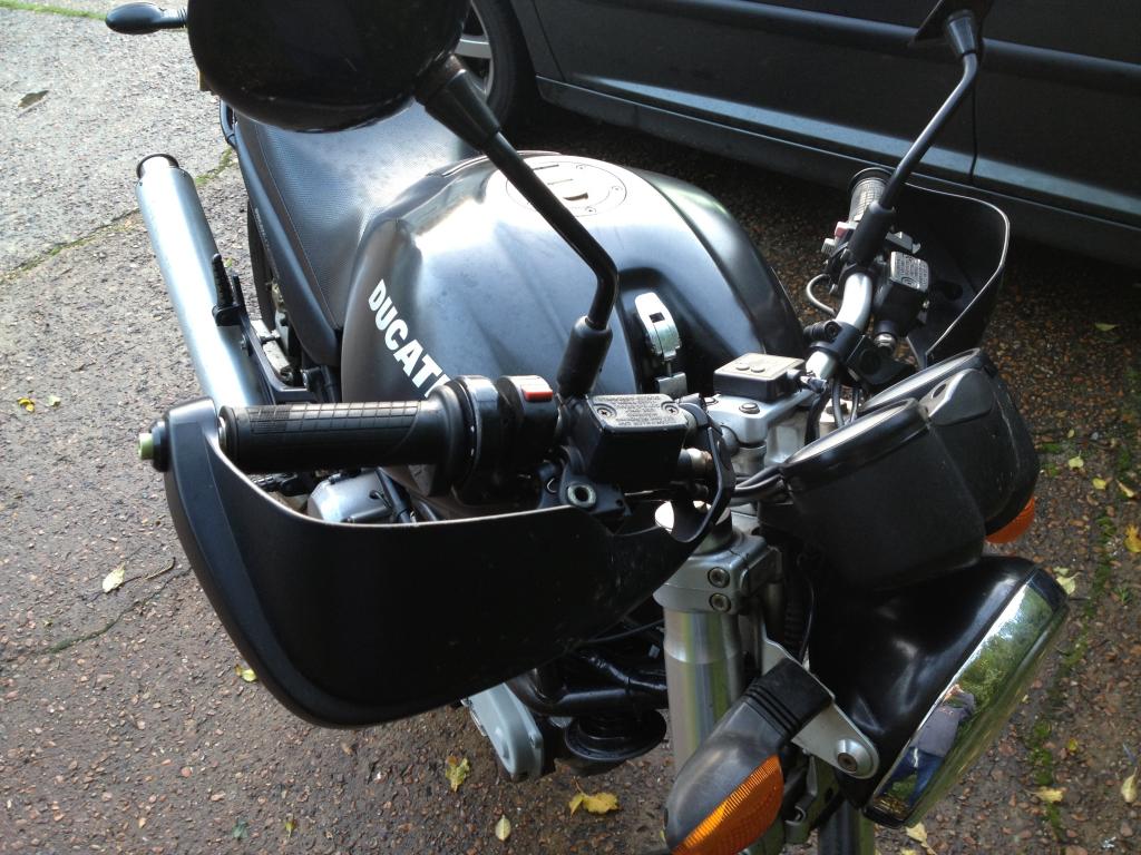

  7. I fitted bmw gs hand guards to my monster 600. Fantastic. I'll post a pic up later to show u.
  8. I've taken pics, will upload them tonight. They're BMW R1200GS ones. The one piece type as I've seen 2 versions of GS ones where they are in top and bottom halves. Fit to the standard Monster bars, you will need to cut away a little to clear cables etc but one of the best mods for winter these are. They made as big a difference as fitting decent heated grips did for me but now I don't get the windchill on the back of my hands anymore.
  9. [​IMG]
    uploaded some better photos.

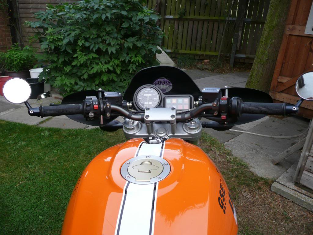

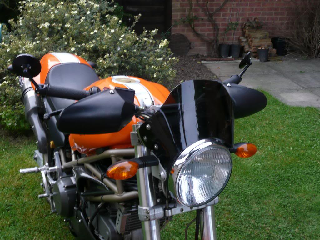

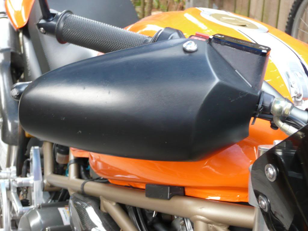

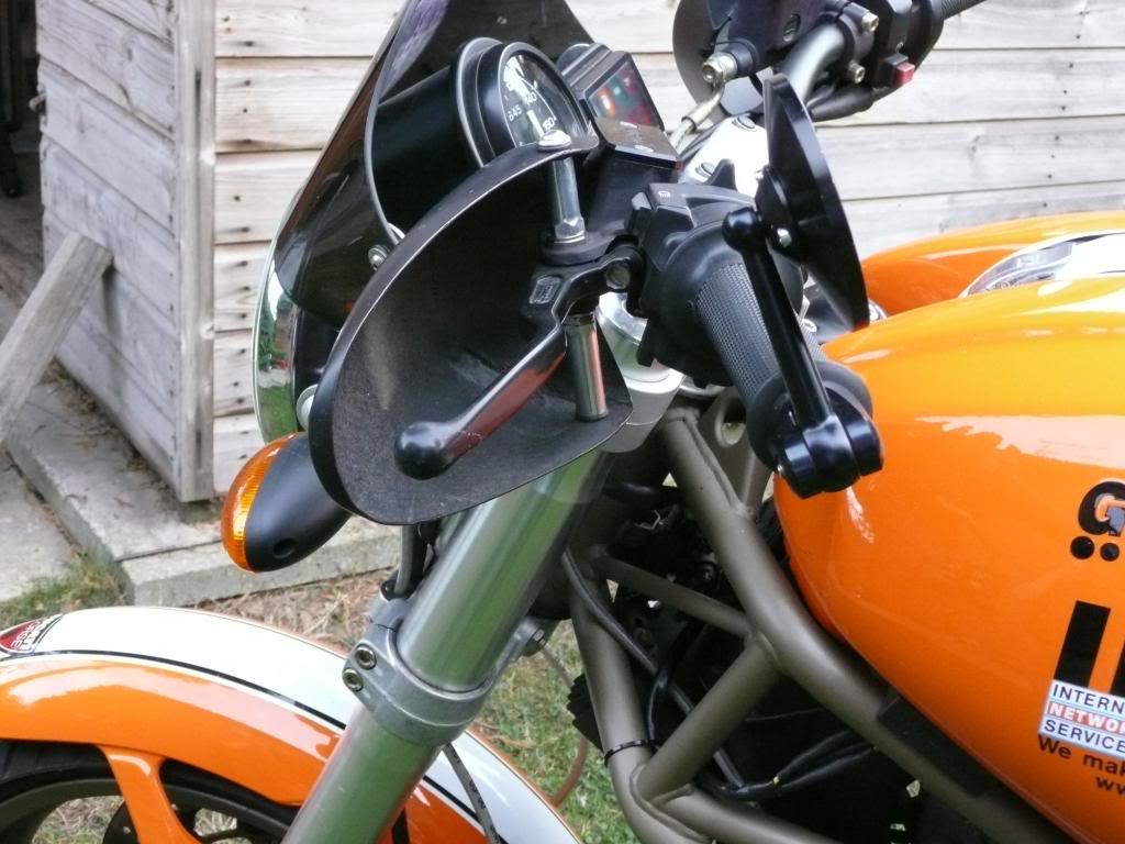

    Without wanting to blow my own trumpet too loudly, my design is much better than those BMW ones, imho.
    They fit directly to the master cylinder units, and have no fittings to the bars whatsoever, so they're neat looking and easy to fit.
    They also put more protection where you need it most, while also being narrower due to the lack of a fitting at the bar ends.
    And they're quickly detachable in about 5 mins.
    I'll post some pics when I've learnt how to do it.

  15. Here's some pics ....I think ...possibly.

  16. Ahh so they get secured through the pivot point in the lever. Very clever :upyeah:
  17. Thanks, Matt.....but I nicked that idea from the hypermotard.
    The real design breakthrough was the third fitting, which is simply a cable tie around the master cyl spigot which engages with a stainless steel hook embedded in the handguard moulding, leaving no need for a bar-end fitting.
    This makes them neat, narrow, very secure and quickly detachable in just a couple of minutes, and of course it means you can still fit bar-end mirrors, as in the pics. That bit of design is all mine.
