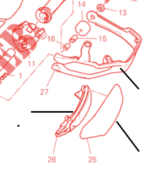

  1. Does anyone know how easy it will be to swap the front indicator and the top and bottom handguards? My bike came with some damage that needs fixing properly so the dealer (not Ducati) has said for me to purchase the parts or they can. Just wondering how easy it will be as wasn't sure where the indicator plugs in?
    I need all these 3 parts I think as the screw holders are smashed on the top and bottom guards.
  2. Very straightforward, I’ve replaced about 4!
    They break very easily (part 27)
    I haven’t had to replace the actual indicator on this model, they are a bit more robust now. Pretty sure they just plug into the loom under the front fairing.
    If the dealer is offering to do it then maybe let them unless it’s inconvenient?
  3. The indicator isn't broken as such but the screw holders are so think it would need to be replaced as well.
    It's not a major problem to get the dealer to do it be fair, so I'll get them to order the parts and then I pop it in as they are local to me anyway.
