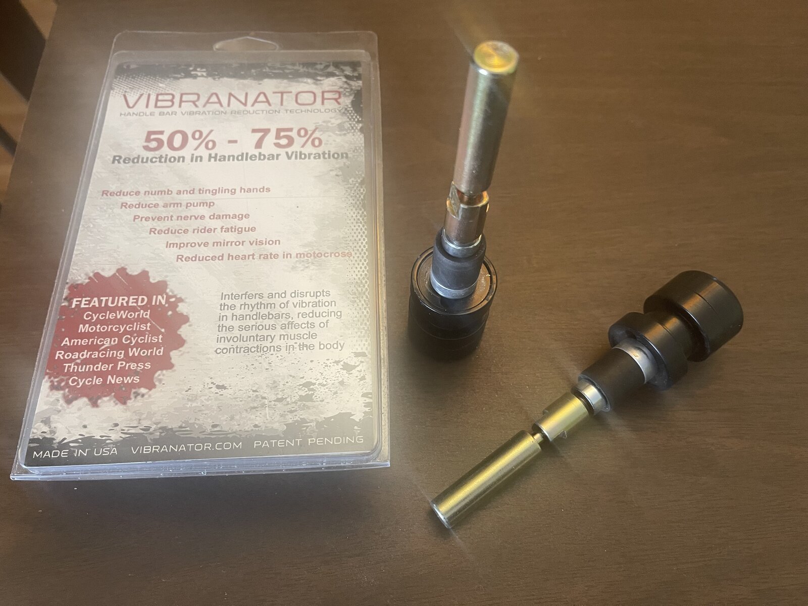

  7. You might still be able to get these (FleaBay, etc.). I used them on a Gixxer 750 and they seemed to help. The idea is the mass inside the bar is free to resonate at the opposite frequency (hopefully) and offset the vibration.
    https://en.wikipedia.org/wiki/Tuned_mass_damper
  8. Sorry - photo didn’t load. upload_2024-3-8_11-11-41.jpeg upload_2024-3-8_11-9-32.jpeg upload_2024-3-8_11-9-32.jpeg
