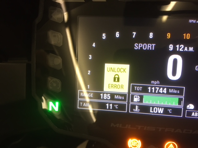

  1. Has anybody experienced a fault with the hands free system where it won't swithch on the ignition unless the key is placed directly on top of the instrument pannel.
    I have changed the battery last September as it would not switch on one morning when I was on a tour and it cured the problem.
    I have changed the battery again but wont switch on when the key is moved away from the pannel.
    Is the ariel for the key system in the instrument pannel?
    I had the pannel replaced at 15K mls as it had the standard water ingress fault.
    Since then the stearing lock operation has been intermitent. Dealer advises that this is a software update and was wondering if the hands free neeed a similar update?
  2. yes, only once has it dropped the signal. See manual about re-connecting the transponder thingie.
  3. The antenna is in the beak. I have an intermittent problem when fueling, which is somewhat common here in the US and believed to be RF interference from the petrol pumps.
  4. I have been through the manual but cant find anything about reconecting the transponder.
    I have got it to work but you have to put the key directly on top of the instrument pannel.
    Operates ok so guess its a signal strength issue as the arial is just below.
    Going to try another new battery ... Duracell this time as i have read that some of the Energizer ones are shyt! Long shot but worth a try.

  11. My hands free unit has trouble working in the cold , if the temp. goes down to about 10 degrees C or lower it doesn't work , above that temp it always works , weird .
