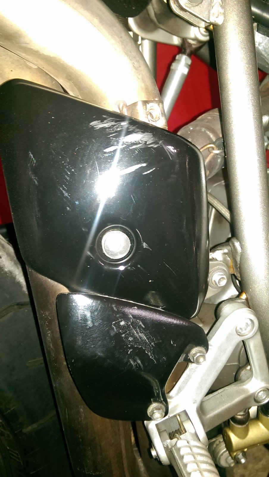

    Painted my heel plates and heat shield on the 996 black over winter and put clear coat over the top but a few hundred miles later it is wearing off.
    Any suggestions as to what will be harder wearing?

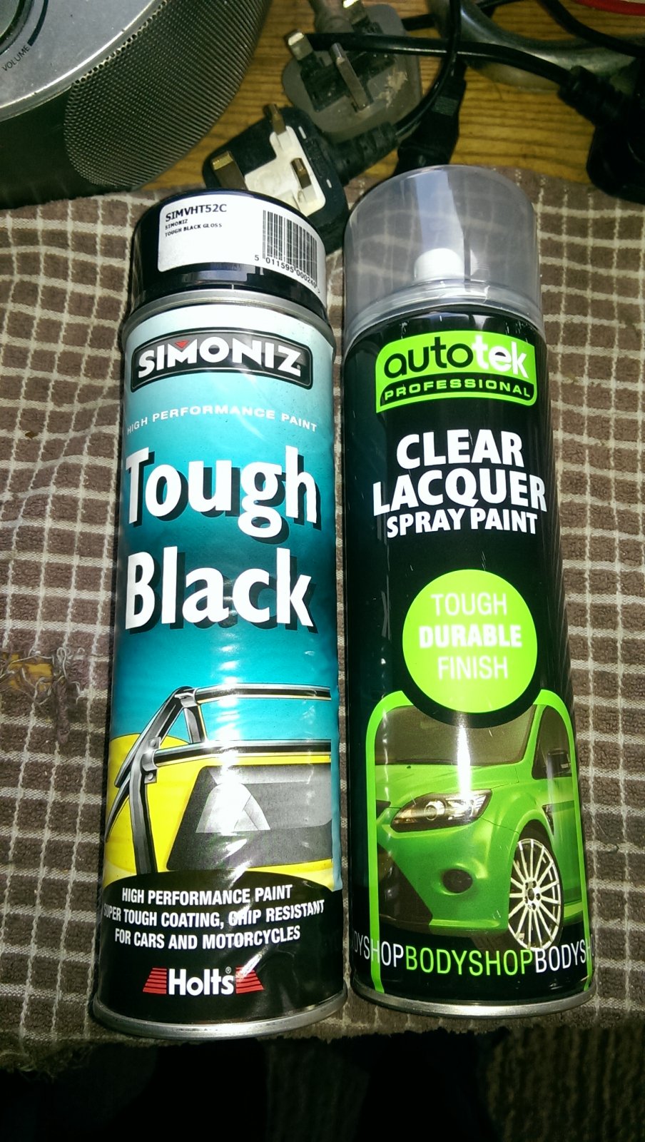

  6. This is what I used last time and the results.
  7. You will not get the thickness or coverage with spraying using cans. For metal have them powder coated as the thickness of powder coating can withstand the most wear.
    If you want to spray over carbonfibre then the best and cheapest way is to vinyl wrap them and when it wears just lay over a new piece.
    If you want to paint the part it needs to have a good primer and basecoat followed by a decent top coat of lacquer if it needs to be a lacquered finish.
  8. Just want it black and not to wear so quickly.
  9. Paint it black and then use flat lacquer, easy to rub down, smooth and recoat.

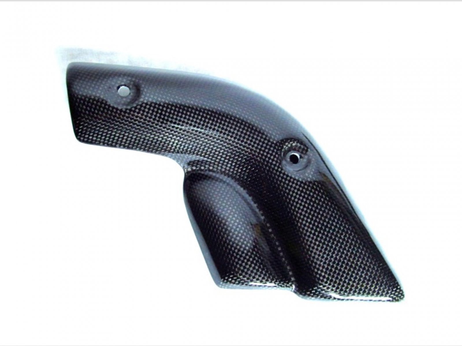

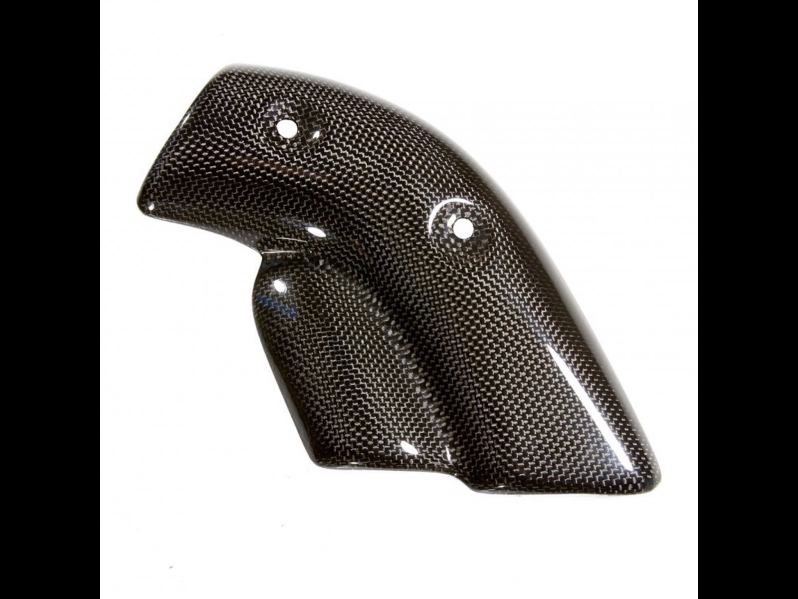

  13. You've probably got a mix of cans & link pipe so it's a bit odd, the original style guard is the one you're using which has 2 fixings on the link pipes, the cans you've got have the fixings for the Corse style guard.
    They look like this
    There are at least 2 different lengths/styles and there are 2 different fixings either 75mm or 130mm apart
    with these there are no fixings on the link pipes
