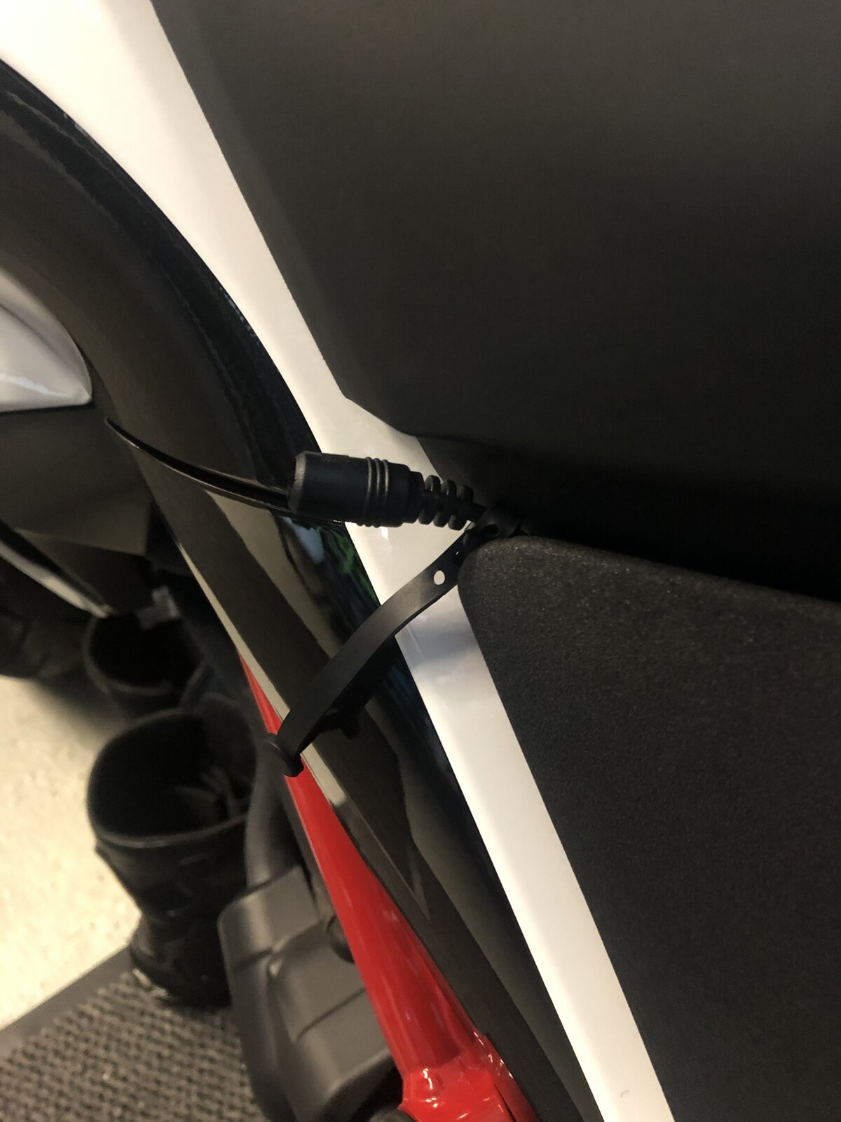

  15. Got the dual remote. Will be having a crack at wiring it into the battery tonight. I’ll post some pics of the end result... providing the bike doesn’t end up in bits.

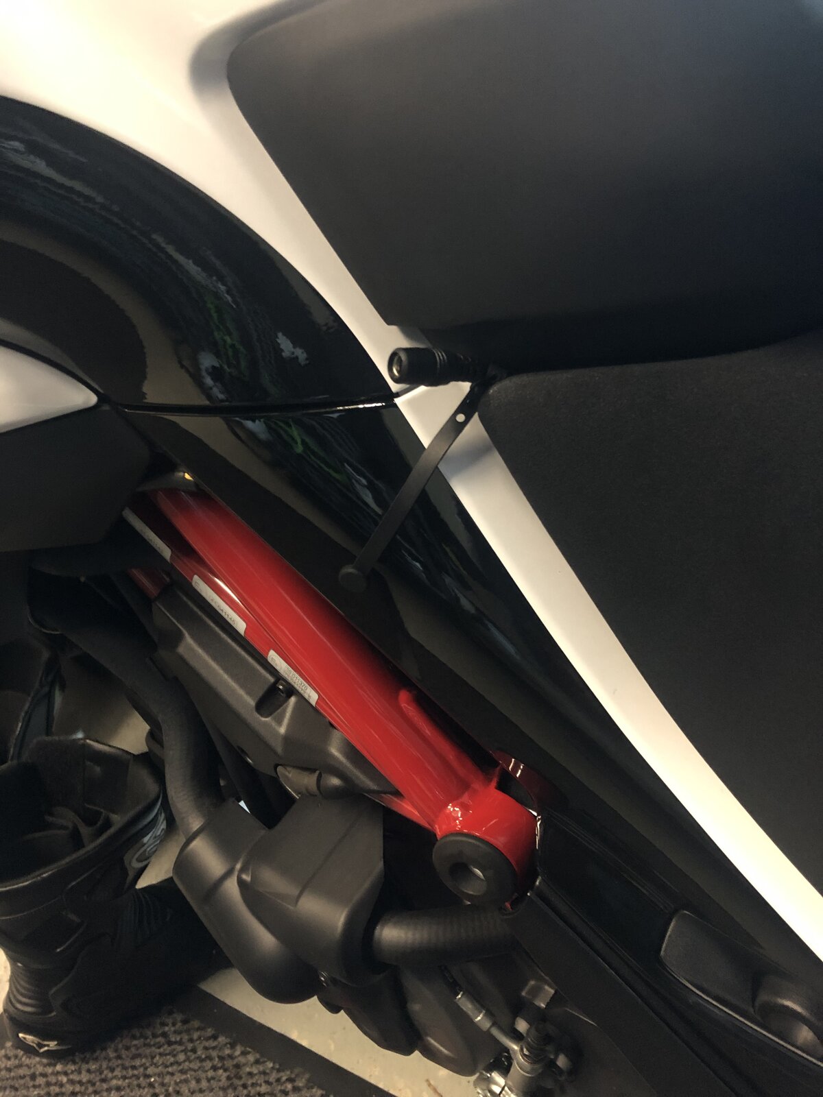

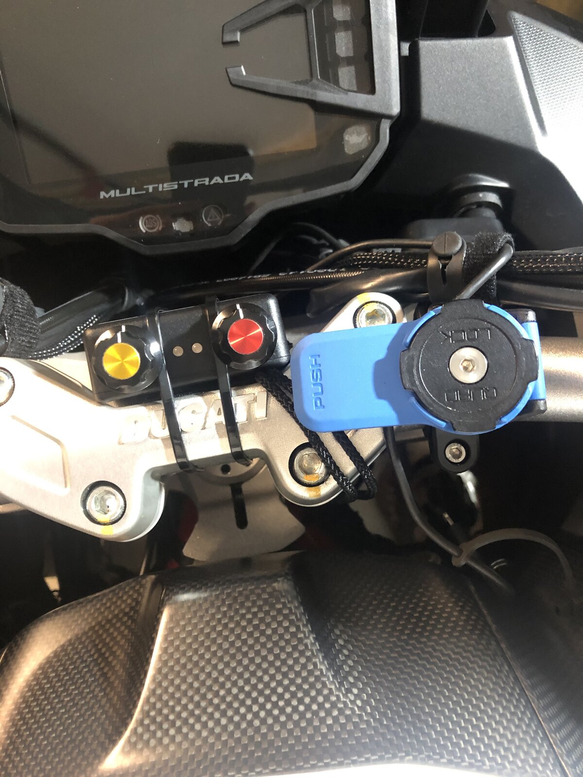

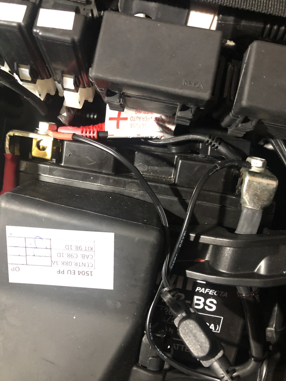

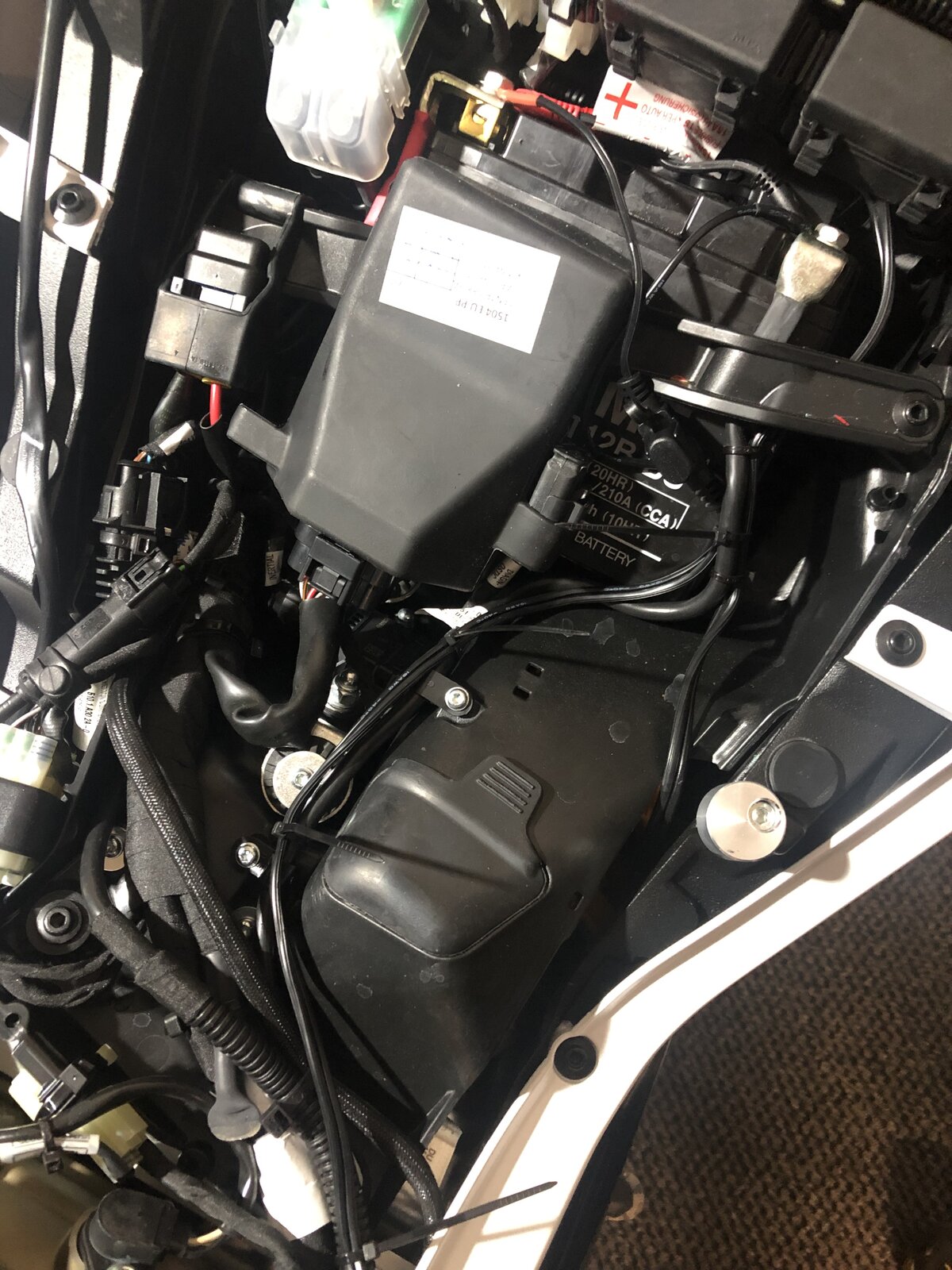

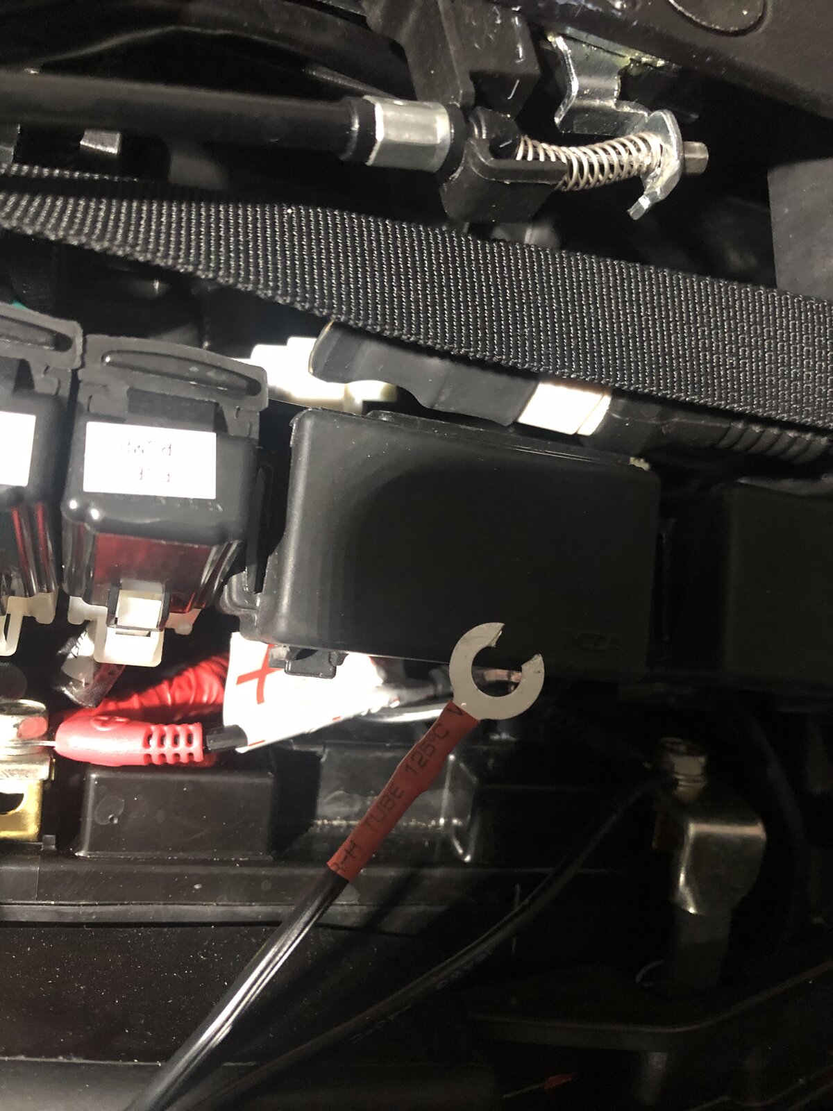

  16. 08AC6081-58A8-49B8-9387-A34158ED2611.jpeg A45B0A88-FF5A-4B57-8DCA-B3881FD52F4B.jpeg 584322C6-D49F-42DD-B788-09337FECB6A5.jpeg C0E3D090-0ECD-4343-90FE-AE4B81EEE364.jpeg EEF898E9-CE31-4CFA-803E-38F5D073B8F0.jpeg ACA026C2-DAC6-454A-B064-D6CCA4B52045.jpeg 08AC6081-58A8-49B8-9387-A34158ED2611.jpeg A45B0A88-FF5A-4B57-8DCA-B3881FD52F4B.jpeg 584322C6-D49F-42DD-B788-09337FECB6A5.jpeg C0E3D090-0ECD-4343-90FE-AE4B81EEE364.jpeg EEF898E9-CE31-4CFA-803E-38F5D073B8F0.jpeg ACA026C2-DAC6-454A-B064-D6CCA4B52045.jpeg Here’s my efforts, took about half an hour in total. Hardest part was loosening the battery terminal bolts, the Ducati builder definitely had three shredded wheat when he was building my bike.
    Cut the ends off the connectors on the cable to make them slide under the bolts easily. (Good tip SteveE)
