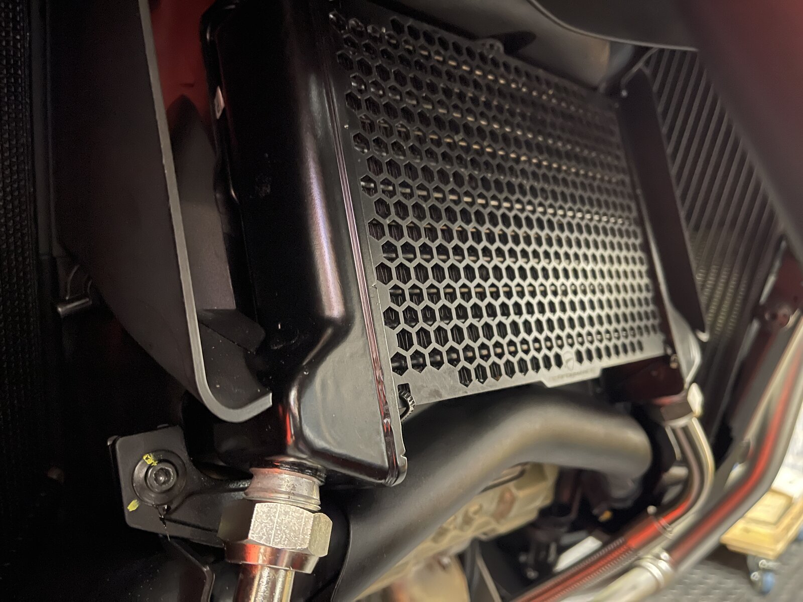

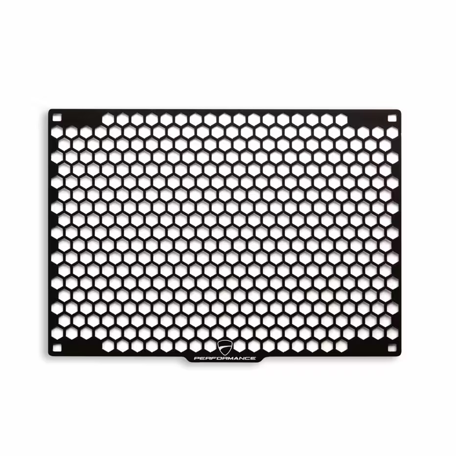

  1. IMG_3317.jpeg Just fitted the official Ducati Oil radiator guard Part No. 97381181AA. Its held onto the front of the radiator by threading 4 cable ties through the radiator mesh in the corners and looping back to the front to close the cable tie. The fitting guide says 15 minutes!!!!
    Its taken me over 90minutes as what they don't tell you is that there's plastic back fixed to the back of the radiator and getting the end of the cable ties to loop back to the front of the radiator when there's no access is nigh on impossible.
    #1 Martyn Edwards, Dec 16, 2023
    • WTF WTF x 1
  2. Take it off its mounting?
  3. Did that but it only moves a little and doesn't help with the plastic back tightly bolted to the back of the radiator. The only way I could bring the ends of the cable ties back to the front was to push a looped piece of electrical wire behind the radiator prior to threading the cable tie into the radiator, then pull the wire loop which pulled the end of the cable tie with it. Sounds easy when you say it but a pig of a job.

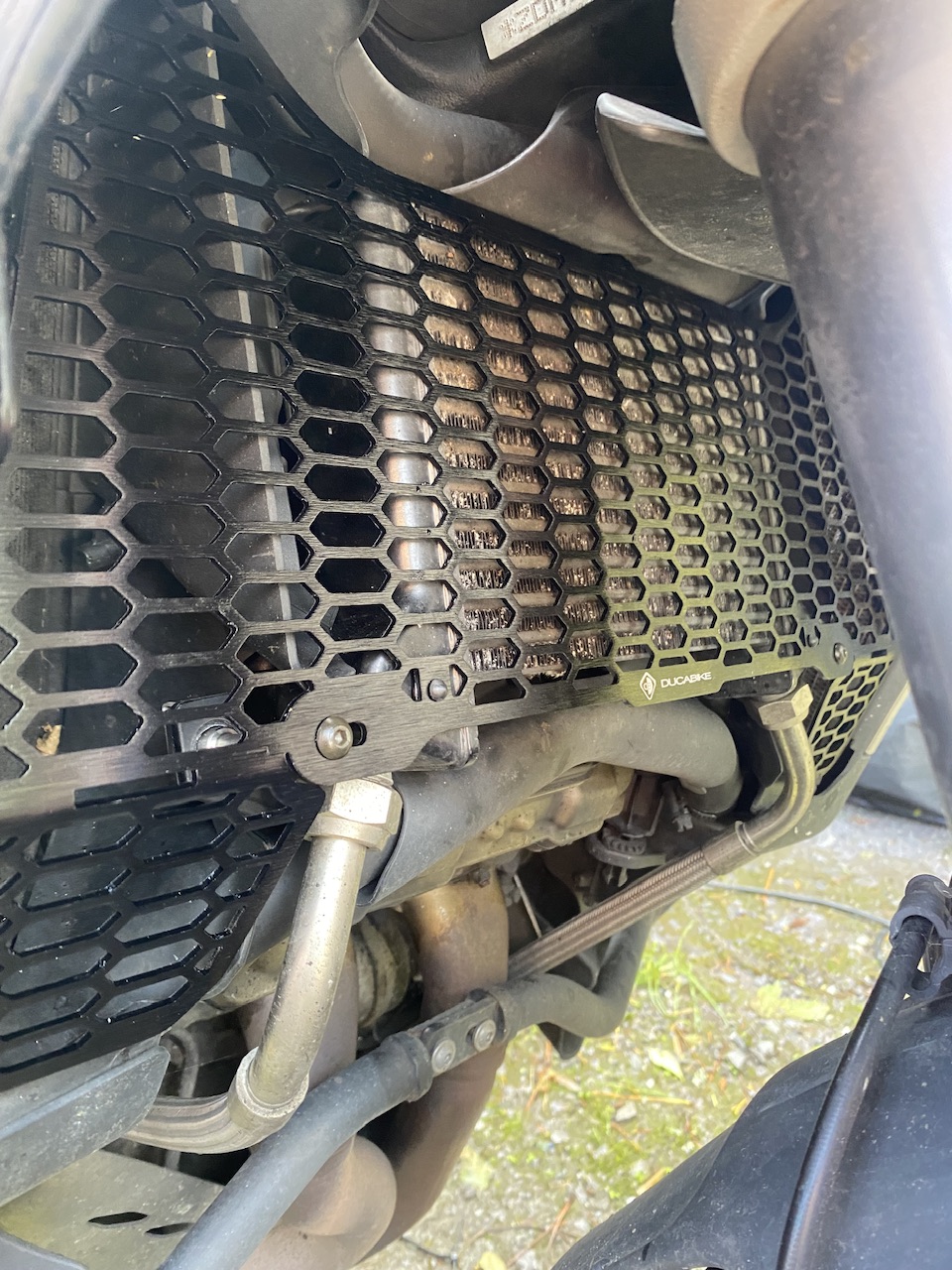

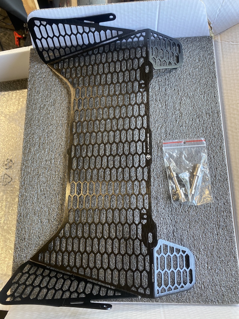

  9. I bought the one from DBK special parts (formerly Ducabike), it’s a one piece design that protects both the central oil rad and the 2 water rads, left & right. It genuinely took only 20 mins to fit (now I know how it goes on I reckon it would take 10mins or less) and is secured in place by 4 bolts.
    Just FYI for anyone else thinking of getting one.

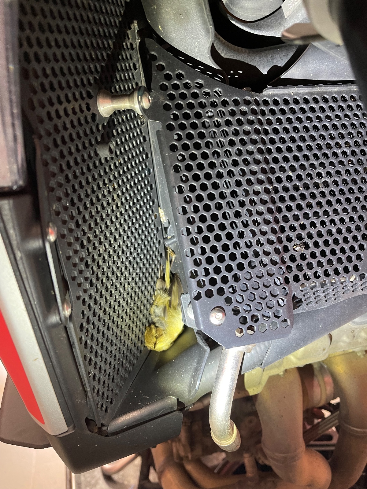

  13. Well, there is the evotech equivalent on Aliexpress (it even uses the same mounting hardware), it is worth four bucks, and it holds perfectly and prevents major problems.
  14. Hell will freeze over before I spend a penny with those utter shitbags.
  15. Have they cloned something that belongs to you?:confused:
  16. You do know there’s a dead budgie in there?
  17. I certainly would not put anything of no known origin bang up against my expensive radiators. very easy for something to rattle and rub through causing a leak.
    Why save £50 on a £20k bike?
