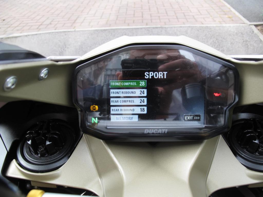

just done 3500 miles on the tricolore through the Alps and Pyranees, and the stock suspension settings are way too hard for the road! current settings now are a vast improvement, will try to send photo of the setup page on the dash.

As above, depending which mode you're in knock the damping settings back. The linkage is either "Flat" or "Progressive". Flat is suggested for track but also for one up riding. Progressive is suggested for two up riding. As a gauge, knock the rider mode into wet and see how it feels. The damping settings are backed right off as default, particularly the rear. If it feels ok/better then transfer those settings into your chosen riding mode. That of course works well enough if you have the S. If not, wind out the compression damping on the rear and a tweak on the rebound. Remember, the spring weight doesn't change...it's the linkage that is affecting how far it's compressed. In progressive, it gets "harder" the more it's squeezed. For one up riding, flat rate and softening off the damping usually works. The settings in srad34's picture are pretty much those used as default in wet mode.
