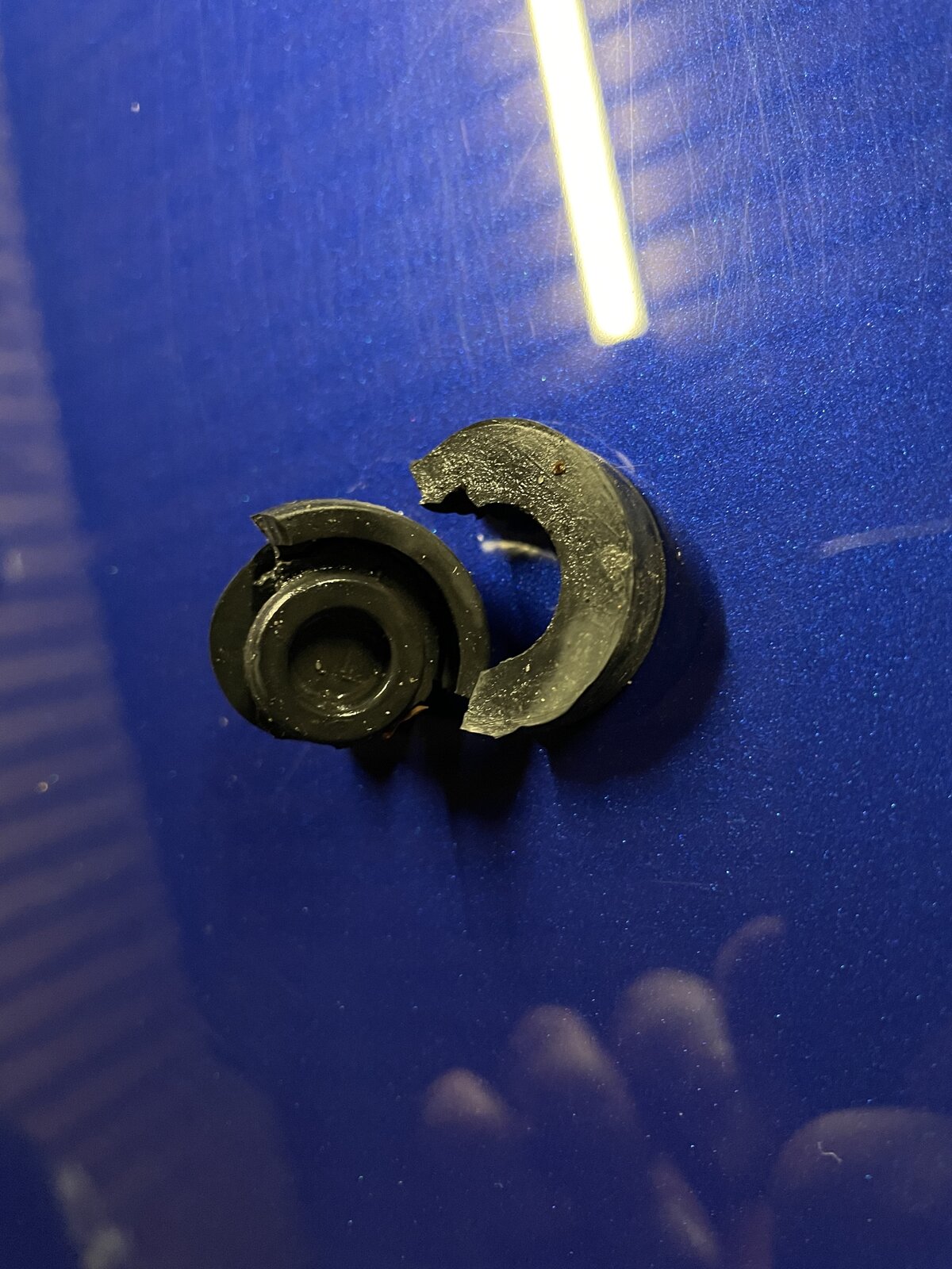

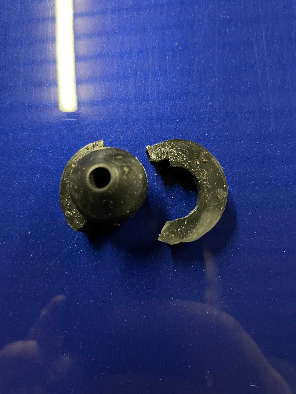

  1. Just washed the Multi today, was putting it back in the garage when I found this on the floor, I cannot for the life of me work out what it is or is it indeed off my bike?
    If anyone knows then please enlighten me if it is indeed off the bike.
  2. Uhmmm... One of the rubber pieces under one of the seats? I own the previous model, but it seems very similar to mine. Or maybe this is the one that stops the central stand...? I remember it to be beefier that the ones under the seats, but it is simple to check, just to be sure.
  3. Looks like the stop on the centre stand that contacts the bracket on the cat.
    Item #10 on here.
    • Agree Agree x 6
  4. Ahhh right we’ll that makes sense as I did have to move my bike a few times when it was on my center stand, bloody hell better find a new one now then.
    Thanks for that I’ve been scratching my head this afternoon trying to work out what it was.
  5. Bumpkin is correct :upyeah:
  6. Urgghhhh better try and buy one in the UK, £2.50 for the part and £25 shipping lol...
  7. Sorted, ordered one form Ducati.com, all in its costs £9, will get it delivered in the new year.
    Cheers gents, hopefully its easy fit.
