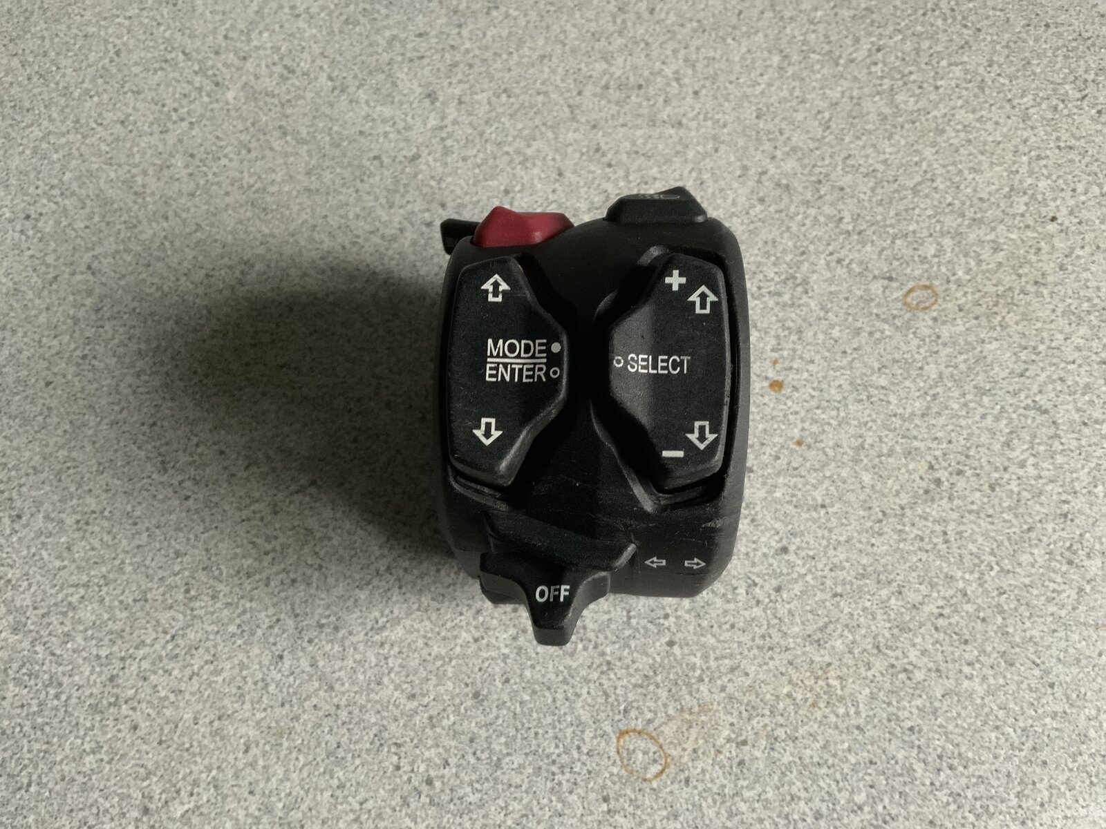

So I picked up a 2018 v4 panigale on Friday. When I viewed it the week before it was perfect. Gone to it this morning and the hazard lights are stuck on. It was washed on Friday morning ,but would have thought it would of dried out by now if any damp had got into the switch gear. Anyone got any idea what's up
Its probably still wet inside. Can you give it a blast with an air hose? If it really is fubar I have a spare one.
This guy found the cable into the switch was loose https://www.panigalev4club.com/threads/hazard-lights-started-blinking-and-dont-stop.1712/
All sorted now, went back to it 10mins after posting, took the xlio on off , and the cable was unplugged.
