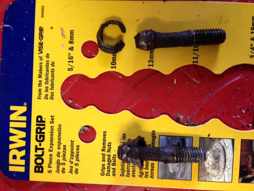

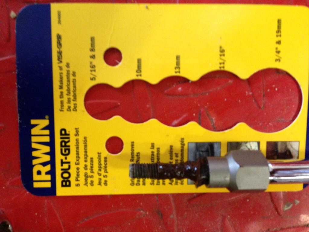

  1. Having got my bike in its new home I have started to strip her down for the winter build/refresh. The lower cylinder area has obviously suffered from severe corrosion and the exhaust header studs/nuts were seriously bad. The nuts had corroded beyond help and a 13mm spanner was too big and they had rusted into the stud and flange. So I bought some bolt grips having seen how well these had worked for others. They pretty quickly did there job, but instead of removing the nut from the stud they have taken the studs out as well. You can see how badly corroded the nuts are and how they have split. Recommended Irwin bolt grips headbolt.jpg headbolt2.jpg
  2. female ribe bits are also very good for removing studs, worn allan bolts and corroded nuts.

  7. My guess is I'm going to have a similar problem with my SL 1's they certainly look bad, the whole engine looks a Manky mess , but I've already restored one last year so this one should be a breeze not !
