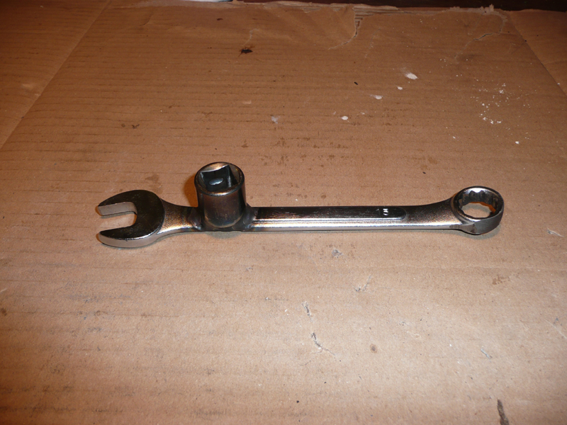

If you can weld then make one from a ring spanner and a socket, like this. Just keep it at 90 degrees to the torque wrench;
had something like this in mind but wasnt sure how it would affect torque figure, cheers for that, am gonna make this thanks, martyn
Martyn This gives an idea of how torque is affected depending on how you position the extension. It should show at 90 degree even if you change the extension the torque figure does not change but I would say keep it as short as possible so not to introduce too much flex in the bar. Cheers Gaz Torque Wrench Adapter Calculator - CNCexpo.com
Scroll down a way and see how a proper torque wrench adaptor should be.... Torque Wrenches from Norbar The peculiar method of using a torque wrench at ninety degrees to an extension is full of potential problems..... ..simply because none of the calculations take into consideration how thick the extension is right where the torque wrench end is levering and trying to rotate in the hole... ..the thinner the extension, the easier for the torque wrench to turn in the square hole, thus completely sodding up any calcs and settings. You might just as well do the buggers 'by hand and feel' with an open end spanner or shaved down ring spanner. AL
I've just used a good quality thin walled ring spanner and given it a good old grunt or two. Never lost a head yet. But if you're not quite the same level bodger that i am, i've seen the correct tool selling for about £80-90 on fleabay.
