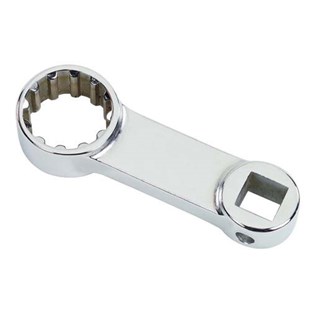

  1. Anyone got a 887132676 head spanner hanging up in the garage needing to be used ? Special head nut tool for a 999 head removal.. :frown:
  2. You don't need it for removal, only for torqueing up when refitting and there are ways to do it without. :wink:
    Is it 15mm or 14mm?
  3. Think it's 14 as cant find that at the moment and the 15 is a bit loose - will need to torque up as when I find out which cylinder has gone off comes the head!

  5. Probably is a 14mm. The older bikes use a 15mm (which I've got but no use to you) but I know they changed at some point, think it was for the testastretta engines.
    If you've got welding gear you can make one from a 'sacrificial' ring spanner or get a 'torque adapter' from the likes of Snap-on, unless someone comes through with a loaner...
  6. Thanks for that -have found a 'adapter' ebay , and they calculate the correction needed as well !
  7. If you keep the adapter at 90 degrees to the torque wrench then you use the correct figure. :wink:
  8. Thanks for that I have order it .. The vertical cylinder has 5 psi the forward on the correct 11. Any idea why the gasket has gone ? Is is common at all . I thought manufacturing incorrect torque setting or a batch of flaky gaskets or maybe rear cylinder getting hotted and distorting the head :-/

  11. Is that what you were trying to contact me about Richard - sorry to hear - looks as though you are sorted now though?. As said, many ways around the loosening/tightening of head nuts - I use a 'zero offset' ring/ring spanner which is custom ground at the 14 end to gain clearance. At the other end you get a generous length of stock 17 hex and can then act on that at 90 deg. Not as common on your 'stretta but there's a small chance it's exhaust valve seat recession on one/both. This is one of the last options on yours though unless neglected. Will p.m. maybe
  12. I use these purchased off the snap on van . I think they are only in inches though but I`m sure 5/8 fits perfect .
  13. Spanner arrived however there is no way one can get it in place and then turn it due to the frame ! Next will be an entire engine drop out or has anyone ever used the ducati special 'u' shaped spanner 887132676 which is for the job ? Just maybe this won't work either due to the close proximity of the frame . Not going to spend £ 100 on that only to find out the same .. Any thoughts ? :frown:
